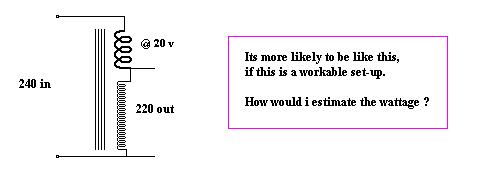

I'm thinking of feeding some of my lighting circuit with a
slightly lower voltage because i am getting too many lamps
burn out, the voltage is around 240, i intend to drop it to
about 220. The lamps are not quite as bright at that, but not
noticeably dimmer. I am hoping they will last longer.
I was thinking of a transformer with '240 in, 220 out' but i
am now wondering if i could just use a 20v winding, 240 in
20 out, and just put the 20 volts in series with the supply.
That would mean instead of looking for 500watts i would be
looking for about 60 or so. And the idle current would be
less. ... if i can do it like that??

I'm not sure about the way the wattage works out with the
'autotransformer' type of arrangement, if thats what it is...
Any suggestions?
John :)

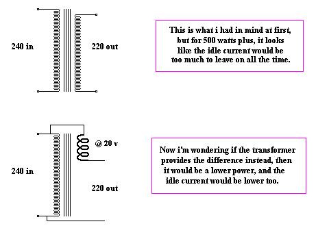

This will probably be the arrangement that i try to do,
i am guessing that the transformer would only handle
the power difference from the 240 to the 220.
That would mean that the transformer could possibly be
handling about 40 per cent of the power transferred,
thats just a guess. (maybe less ?)
So how could i estimate the idle current ?
John

Hi, John
sorry for the late answer, i'm surprised if my computer clock and date go to 2002 jan. i can't see the new posts.
And now understand completely what You need....
You need only 240V minus 20V with 500VA capability.
The current only about 2.2A.
20V 2.2A only about 50VA, so You need a 240/20 (24)V 50VA regular
transformer, the secondary serial in load with reverse phase.

Thanks Sebi,
So that approach is a workable set-up then ?
From what you say, a fifty watt transformer should cover it.
I reckon thats about 50mA idle current, roughly.
