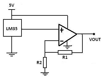

Here's my schematic:
https://www.electro-tech-online.com/attachments/amp-jpg.34774/
so the gain is 1+ (R1/R2), and R1=50 K trimpot, and R2 is a 10K carbon resistor.
Problems:
1. The LM35 heats up easily, so do I need to put a resistor in series into Vin?
2. The amplification didn't work! What's the problem? I've seen numerous schematics from the net, but I don't know which one should be used, so I chose this one for starters. So we can work a way slowly from here.
I use LM358 for the op amps.
Cheers.

The LM35 should not heat up when using a 5Vdc supply.
As drawn your circuit should work, it suggests that you have wired the LM35 or LM358 incorrectly.
What voltage do you measure on the output pin of the LM35.?

2. The amplification didn't work! What's the problem? I use LM358 for the op amps.
Cheers.
Don't see why you want to amplify the output of the LM35 anyway. Its output is a voltage that directly corresponds to the ambient air temperature. If you connect a digital multimeter set to read voltage across the output and ground of the LM35, you will see a direct temperature readout by simply moving the decimal two places right. Example: .268 represents a temperature of 26.8 degrees C.
No amplification needed.
If the LM35 is self-heating, you have it miswired! (or it has been damaged).
Your amplifer should work, except that the LM358 is not rail-to-rail on its output, and with its supply pin tied to +5, it will only pull-up to ~3V, so if the gain is set too high, even with the ambient temperature at 25degC, the output may saturate.
If you have a higher positive supply available, like 12V, power just the opamp on that. That way, the output can pull much higher...
Another way; get a genuine rail-to-rail input and output opamp.
Yet another way; add an offset circuit to the inverting input of the opamp so that the output swing is shifted downward.

Well, I'm going to feed its output to a PIC, and the output is too small since the Vref of the PIC needs to be small enough to detect small changes of the LM35 output. This might mess things up when I have a other types of sensors to be used in this system, I suppose.
Anyway, there should be quite some changes in the output if I touch the plastic casing of the LM35, right?
Yes, there should be a very definate change in output. If you attach your dmm as I described, you can observe this change for yourself. I use the LM34 myself, (same chip except it reads in God's temperature, not man's /jk) and have observed some very subtle changes in output, coniciding with other electronic thermometers.
There was another poster here a couple of days ago experiencing grief over his LM34. Turned out he had it wired completely backwards.

Yesssss.... It worked.. my mistake is to see the LM35 view as 'top' view rather than 'bottom' view.. hence the heating and dysfunction..
I tell ya... I've been trying to amplify signals over a year... today it worked.. whew. Lesson the hard way I guess. :eek:
