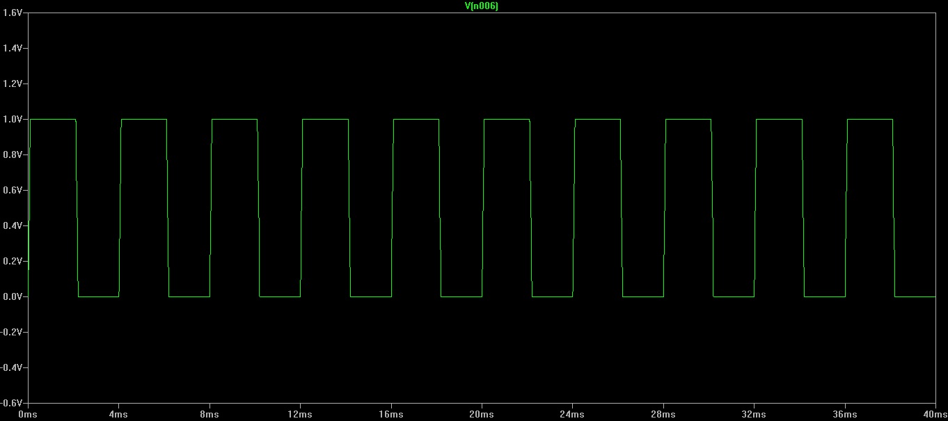

The following two opamp circuits (schematic attached) are exactly the same except for the fact that one has a 5V single supply and the other has a +/-5V dual supply. They both have the same shape of input signal which is also shown attached.

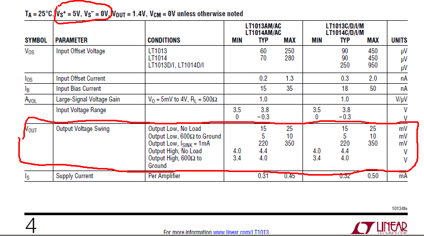

Thansk, i believe the simulation is fairly accurate, so i dont think they're acting like comparators(?), and surely theres not a "problem " with outputs "trying" to go below ground(?).
Our worry is that the single supply opmap may suffer slow bandwidth when its output is near zero volts, and therefore, its output voltage woudl be more distorted and delayed compared to the split supply opamp.
Indeed, i believe opamps behave best when their inputs and outputs are inbetween the supplies, or at least 1.2v away from them....even though LT1013 is rated as being "rail to rail input and output", i still suspect the single supply version will be distorted in comparison with the split supply version? (not in the sim but on the bench)
Directly from the LT1013 data sheet:
The LT1013 (and LM324, LM358) cannot drive the output pin all the way to ground, and that is where the single supply version falls short. With a resistor tied from output to ground, it gets better. If I sweep the dual-supply circuit to determine Vout vs Vin, I get a transfer function of Vout = 1.08-Vin. (Should that be 1.10-Vin?)
I model the Vout = 1.08-Vin function as a simple Behavioral Voltage source, B1 and use it as the ideal... I sweep the single supply version input from 0V to 1.00V, and plot the error V(2ndStage)-V(ideal), and you can see where the linearity goes bad as U2 cannot pull low enough.
