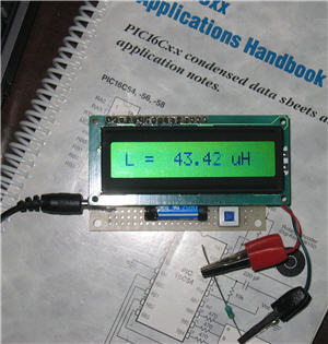

As for the LC Meter, Heres the site with the 16F628A code & schematic.
And here's a photo of mine.

William At MyBlueRoom said:
I tried building that part, could never get past the USB driver for the 18F4550. Nice ICD, tell me if you get it to work.
I'm still laying it out my version, however there are several guys on EDABoard who have theirs up-n-runnin' already.
Looks very nice Bill.

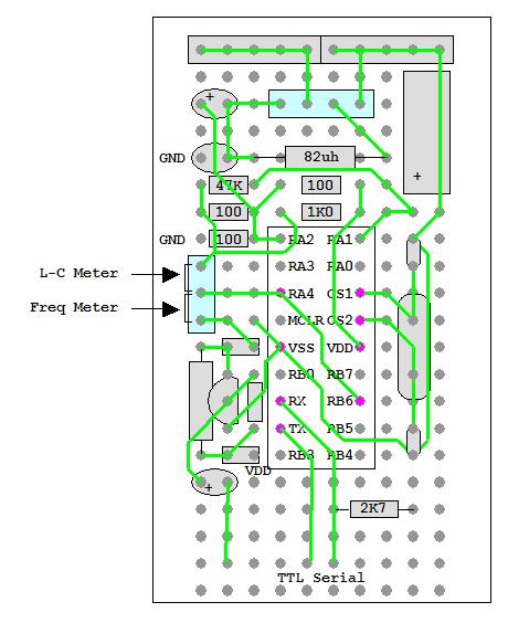

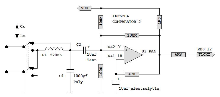

That's the same design I tried but I think I was a little too agressive in my design changes and I have to get back to work on it sometime soon. My design used the serial port and Hyperterminal instead of an LCD and I also eliminated the LM311 comparator (the LC oscillator) in favor of the '628A internal comparator (also used as an LC oscillator). This required using TMR1 for the frequency counter instead of TMR0.

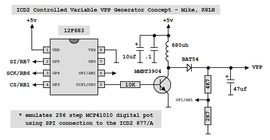

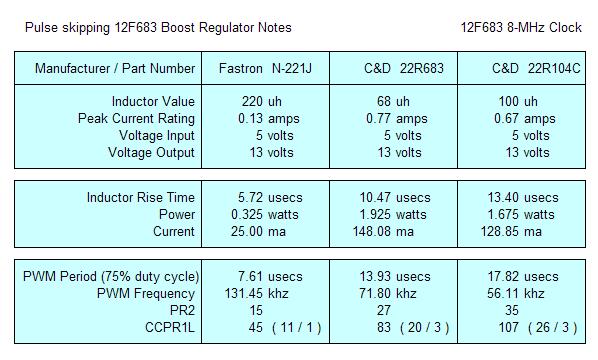

I'm just getting ready to start experimenting with the 12F683 boost regulator design after studying the Inductor formulas in a spreadsheet. I suspect I might be able to get away with the little radial 220uh/130ma inductor for variable 10v to 13v output at 25-ma. What do you Gentlemen think?
boost-formulas-jpg.8605
Bill was right. You need A2D feedback for a "pulse skipping" boost design.
Any comments/suggestions/criticism welcome. Regards, Mike
Question, which is better; do you "skip pulses" or vary the duty cycle?
At this early point, I have no idea (grin) but it'll be fun to experiment with the values.
Mike
One of the guys on EDABoard just passed along this link to a reasonably comprehensive Boost Calculator which is helping me figure out the relationships. Pretty cool.
Is this a working unit? Any .HEX file for it. I have some 628A I ordered and have not opened yet. And a good LC meter I need for sure.. I can hook to an old 386 laptop with a serial port. Is the TTL RS232 inverted?
Single Chip L-C Meter ?
I need to dig out the circuit board and work on it again soon. The code was not complete but I did have the comparator setup correctly and it was oscillating around 500-KHz. The frequency counter on TMR1 was working too but I was disturbed by the amount of oscillator frequency drift and I was wondering if it was because I was using 1/8th watt resistors and had everything crammed into a very small space.
When I figure it all out I'll publish it in the Projects forum for everyone to enjoy.
Meanwhile, that dual-chip (628A/LM311) design is proven and tested so you might want to check that out.
Mike
