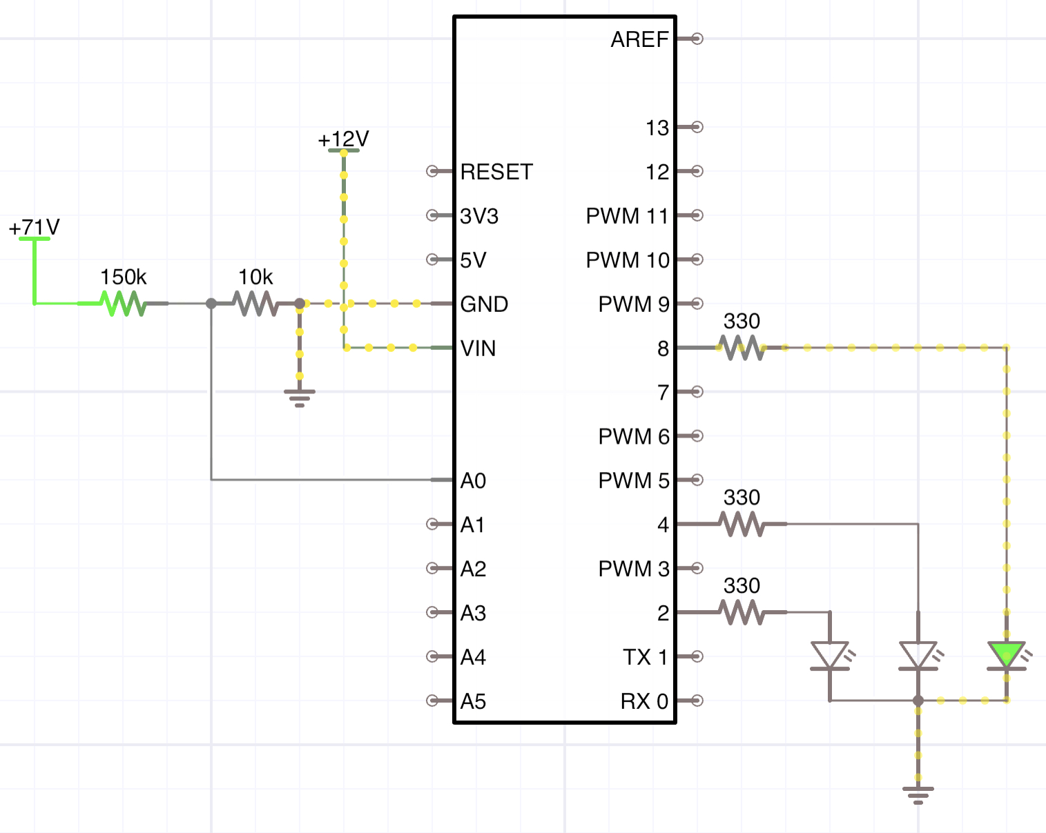

I wanted 60v battery level indicator circuit. Can anyone hep??

Arduino and ADS1115 using this circuit possible??
The battery level indicated on LEDs (0% red led, 50% Yellow led, 100% green led )
If you just put a 150k ohm (connected to positive of battery pack in series with a 10k ohm and connect to ground. Then use the on-board ADC (I.e. analogRead(A0)). This will give you a reasonable range of 0 to 80v on the 5-volt scale (assuming you're using a 5v Arduino). The voltage divider will draw only 0.5 mA.
that is 80v battery will read: 1023 = analogRead(A0).
40v (absolute minimum discharge = 511 counts
Full charge (absolute maximum) at 3.65v/cell = 73 volts = 933 counts.
So your working range should be 511 to 933 counts or 422 counts over the 33v working range.
This is just a bit better than 0.1V per count as resolution.
no need for an external ADC.

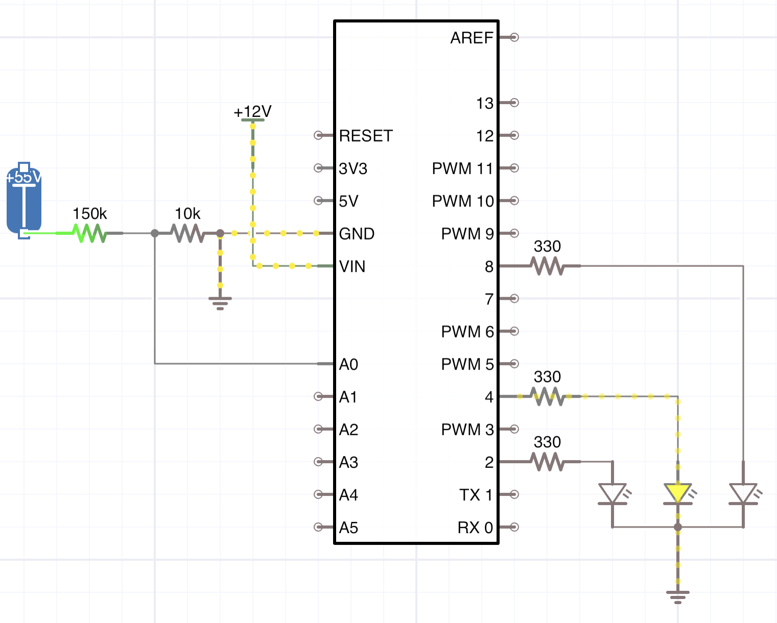

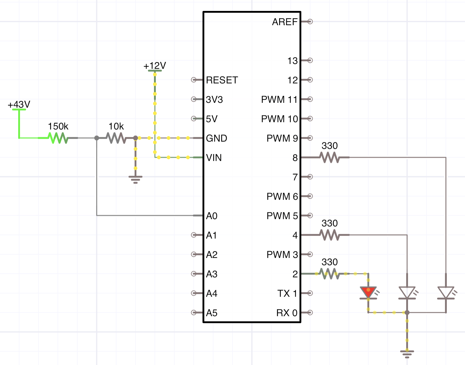

C++:
void setup()
  pinMode(2, OUTPUT);
  pinMode(4, OUTPUT);
  pinMode(8, OUTPUT);
void loop()
  int i = analogRead(A0);
  if (i < 562) {
    digitalWrite(2, HIGH);
    digitalWrite(4, LOW);
    digitalWrite(8, LOW);
  else if (i < 740) {
    digitalWrite(2, LOW);
    digitalWrite(4, HIGH);
  else {
    digitalWrite(8, HIGH);
    delay(1000);
