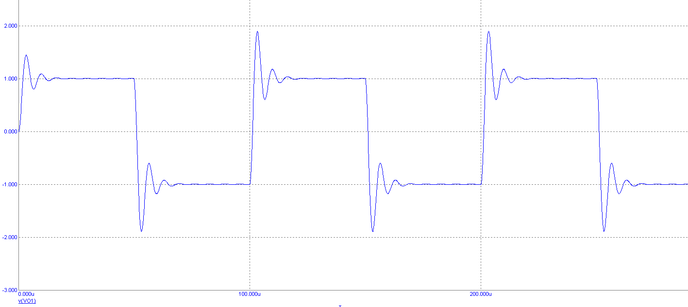

The green plotting is the step response which is I'm trying to make look good.
Hi again,
In order to demonstrate this you need to use a clean square wave input, not a square wave that is partially exponential as your drawing shows. Im not sure if this is what you are doing or not though, so you'll have to check. Make sure the input is a nice clean square wave with sharp corners.
You'll also note that when going from underdamped to critically damped you'll go through a no man's land, where the underdamped will look like a pseudo critically damped. This means you will have to change the values a little more to see the wave you are looking for. Try lowering R as that usually works if you're close already.
I would suggest first trying the values i gave you as these values will definitely work if your input is a true square wave of any positive amplitude (see attached drawing)...
My square wave is the blue plotting. Its flat upper part is not visible because of Matlab image exporter. I think you confused it with the red one; it is a different plotting, it is step response of an RC circuit.

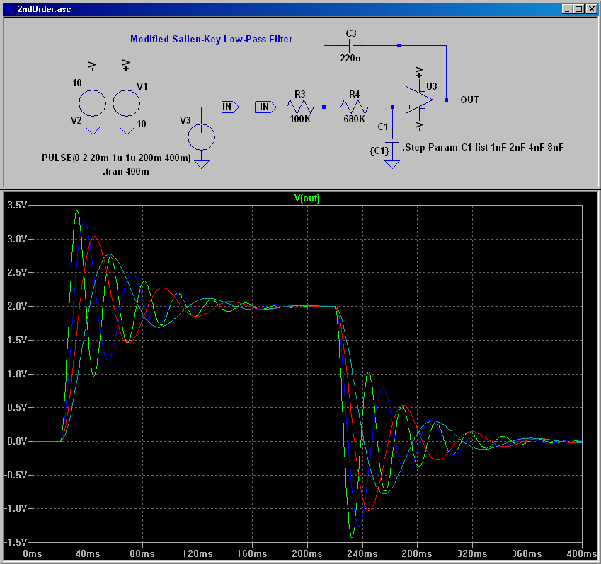

A Sallen-Key Low-Pass filter, modified by changing one capacitor exhibits the peaking you are seeking. Note how changing C1 effects the damping...
I'll let you write the equations to solve this in the general case...

Hello again,
Oh ok, well that's fine then. If something else is wrong then i guess you'll have to find out what it is. I gave you component values that clearly illustrate a second order under damped case so you should be able to get that to work.
