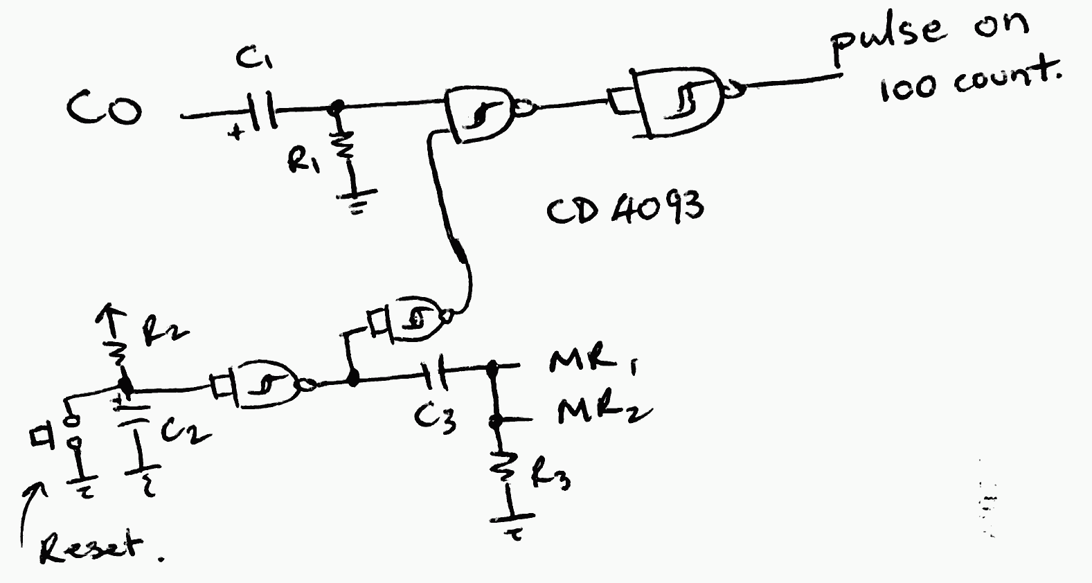

The pin 5 (CO) of the lower device will have a rising edge on the 100th input clock (and on power on). The CO is high for half the counts, so you may want to add an edge detector and/or some other logic.
Would it be possible then to add the "and" gate at CO and one of the other outputs so I'll get my high output for all 100 counts?

to reset the counter, a high pulse on the reset pins of both ICs, so, I'd need to raise them from ground with let's say a 10K resistor and place the high pulse on the reset pins.
If you use an AND gate, you'll get a pulse as long as the time between the 100th and 101st pulse. You'll also have to use quite a few inputs, and you'll also have a high pulse when you turn the device on (and whenever you reset it).
A perhaps more usable method is to detect the rising edge of the CO, and use a timer to mask the output on reset (and power-up). The values for the resistors and capacitors can be calculated using t=1.1*RC, and you want 1.1R1C1 to be the length of output pulse, R2C2 > R1C1, and 1.1R3C3 should be some small value (e.g. 100ms).
Interesting. And thank you for taking the time to draw out a schematic.
I use a car radiator fan to cool some of the greenhouse when the sun is out. I'll pick off a point on that control board when it senses the sun is up, and reset the counter. More than likely use a one shot (555) then use your suggestion on the CO output.
No problem. If you state the nature of the sun detector output, you may be able to incorporate it without the need for the 555 just by rewiring the CD4093 NAND IC.
