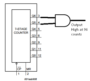

4 digit decimal counter modules are on ebay for under $20. The tech data is a bit thin, but they have a relay onboard and I think they can be preset. If you want to grow your own, a CD4020, 4024, 4040, or 4060 has enough counter outputs to drive gating that detects 100. 64 or 128 would be easiest, but decoding 96 would take one 2-in gate or some diodes.

YOu probably need to filter signal and use Schmitt Trigger Input and use twisted pair wires between.
However I am seeing the Q 12 output change states before 100 pulses occur.
Do you mean Q6? The 4024 has outputs from Q0..Q6, for 128 count capacity. Q6 will go high on the 64th count, and low again on the 128th count.
As dougy says. It's easy to forget, when working with binary counters, that the most significant output bit goes high at half the maximum count.
I was looking at the Q7 output on pin 3. trying to recall what was what after a week of 12 hour shifts.
But, ah ha! didn't realize that the output goes high at half the maximum count.... Interesting.
so, would I need TWO 4024 counters to get my output at 128 pulses?
Yes, or a single 4040. Another option is to use an AND gate (or two diodes) on Q5 & Q6 to make the output high at 96 counts (that's 64 + 32).
Output goes high at 96 counts, then low 32 counts after that (unless you reset it manually).
