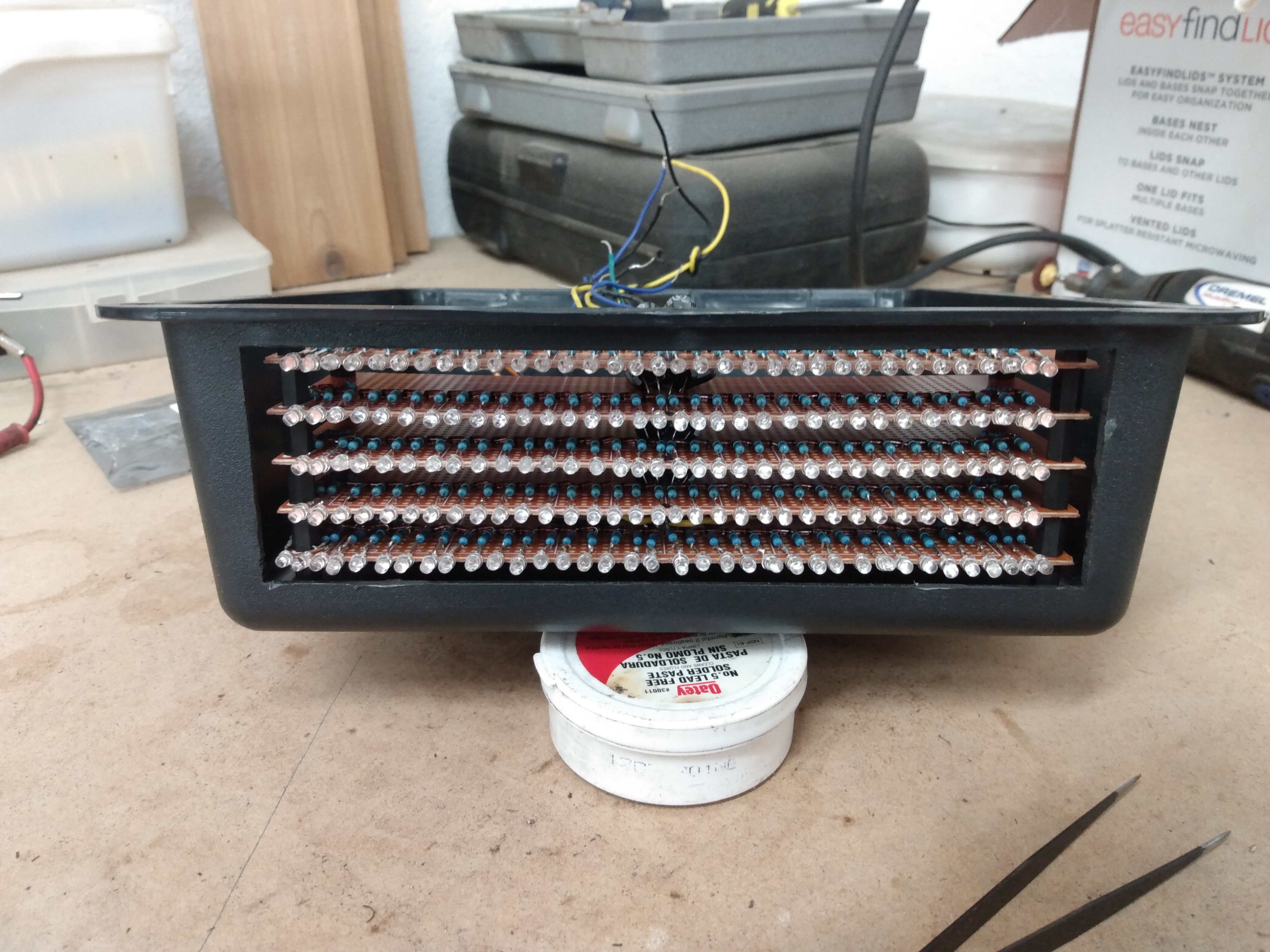

Not enough room in my display housing for 7 rows of lights. Each row of lights is laid on edge of a perf board with 3/8" spacers separating each board. If I use smaller spacers the circuits would come dangerously close to touching the next board, which could lead to a shorted circuit. Plus there's heat generated by the resistors and the LEDs themselves.
Gotta work within the space limitations available. It has to fit inside the window of an automotive DIN radio chassis. Maybe if it were all surface mounted components, but my soldering skills are limited to through-hole perf boards. Maybe I COULD leave off a couple rows and use the MSGEQ7 chipset to drive only 5 rows, but then there would be audible music coming from the speakers that wouldn't be represented by the display.

Lol! The sound system for Project Turd is equipped with a 2nd trunk mounted deep cycle battery, a 1/2 farad cap, 5 amplifiers & 12 speakers (+8 tactile transducers mounted in the seats to augment the subs) pushing 1800 watts, with a battery isolator to charge it when it's running. All the resistors on the LEDs are 510 ohm (instead of 430s) to prolong their lifespan and reduce brightness, plus there's a tinted lens covering them.
