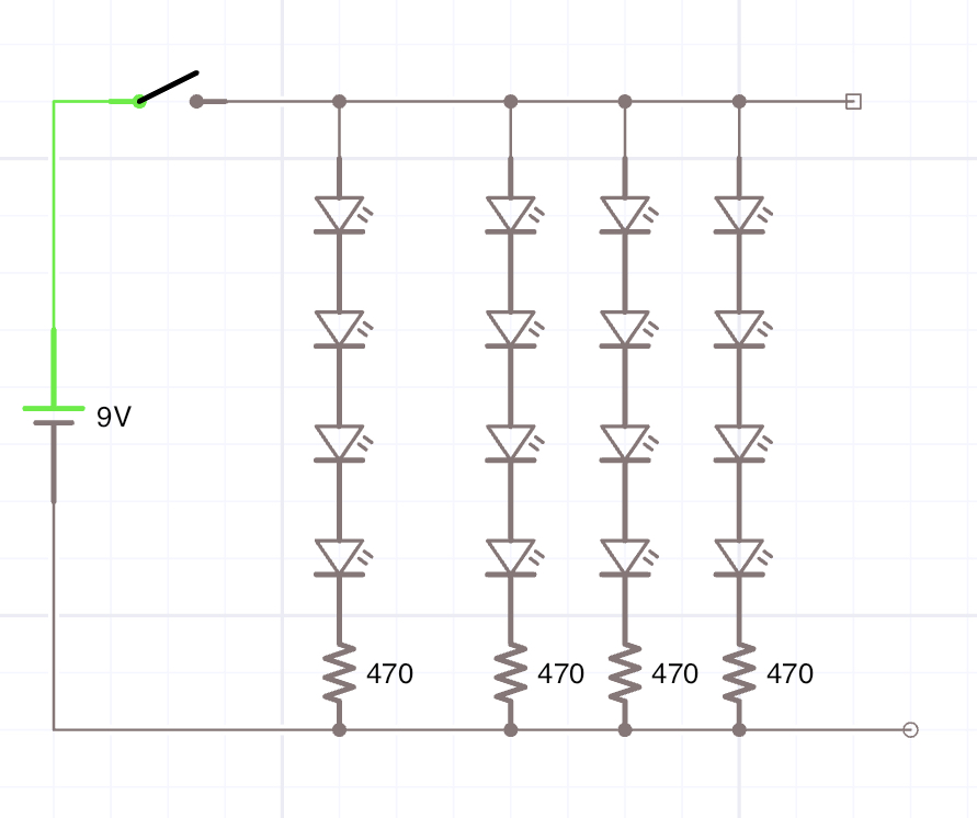

I have a project in mind but I am unsure best way to wire the LED’s (parallel/ series or both)
paul_b_78
Hi all,
I am trying to build a board (using perfboard only) which is a little harder than I thought it would be.
So the idea is, with a battery (Not 5v mains) power source.
I have a PP9 large 9v 5000mAh battery (not the small standard PP3 9v 500mAh) as they hold much more life in them unlike the standard PP3 battery.
I have just over 100 LED’s 3mm (Red) and I have arranged them so they spell out a name (using multiple LED’s for each letter)
My issue iswhat is the best safest way to wire these LED’s so that they don’t kill the battery straight away and can be switched on and off when needed.
I know this is probably a big challenge I set myself, which is why I am now stuck.
Any kind of help would be appreciated

One option would be to put 4 LEDs in series (dropping voltage around 7.2V to 8V) with a small resistor. Then you parallel 25 sets of those 4 LED strings.
Assuming you draw 10ma per string, 25 strings will draw 250ma. Battery would last, at most, about 20 hours assuming the voltage drop is not too much such that the 4 LEDs in series drop out due to low voltage.
If you can reduce the current per string, battery will last longer.

For the little 3mm LEDs, you can put 4 in series with a 470 ohm resistor to get 5mA per strand. Repeat 25 times and you'll draw 125mA. Check for brightness and use anything from 220 ohm to 1k ohm for the brightness you want. Don't go lower than 220 ohms because the 3 mm LEDs are usually limited to 10 mA.
Remember, guys, a "9V" dry battery will drop down to 6V over its discharge life; it will be down to around 7.5V with roughly half its useful capacity remaining.
Four LEDs in series will be fine when it is brand new but will dim long before the battery is anywhere near dead.
I'd suggest a little boost regulator board set for eg. around 12V and use six LEDs in each chain, with a 100 Ohm series resistor.

The OP was already having trouble with a switch and some LEDs, I didn't want to introduce more complexity for the sake of a bit more efficiency. I'm guessing this is a one-time-use gadget.
You guys have been fantastic, thank you.
I did wonder if I needed a boost regulator (or buck converter).
I have one of these laying around spare so will make use of it.
I’ve just realised, one of the letters will have less LED’s (which obviously isn’t a problem as I can wire these LED’s so that the quantity is the same throughout until I get to the last set of lines which will end up having less LED’s.
Could I just change the last resistor to a different value or have I got to try and get all the LED’S to be equal (which I think will become a problem since I cannot see anywhere in which I can adjust the letters to make way for the equal quantity of LED’s without making the letters look o

The plan is to have them all turn On & Off at the same time.
And I want to make the most use out of the newly purchased larger PP9 battery.
The simplest option to guarantee equal brightness is hide the "spare" LEDs somewhere or black them out, to keep all the strings the same size. That allows the brightness of all LEDs to track equally with any adjustments to the voltage.
Or:
You can use a higher resistor value to set around the same current as with the full strings, but ideally you should play around with the rest of the setup and decide the final brightness (voltage & resistor values) first.
Then measure the voltage across the normal resistor, and measure again across both the resistor and however many LEDs will be omitted from the "short" chain.
Increase the resistor value for the short chain by the ratio of those two measurements, or as near as possible, to get the same current in that short chain.
The downside is that the full strings will be rather more sensitive to voltage variations than the short string, which is why I suggest setting the final brightness first.
