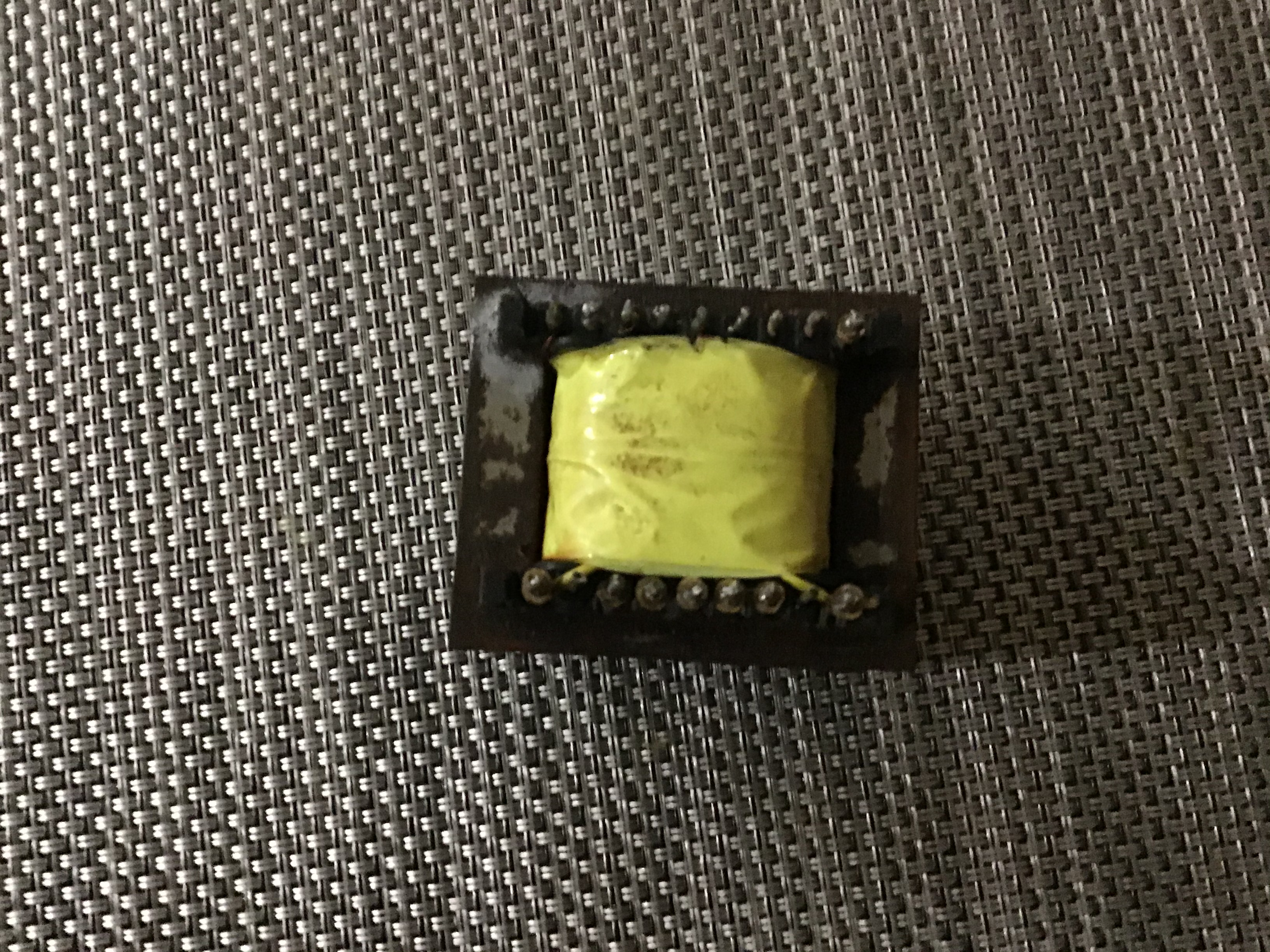

I have noticed that the SMP Transformer has a broken wires on the secondary how can I find out the information about the trans former . Please
I don't think it is an SMPS (switch mode power supply) transformer. I think that it is a conventional 50 Hz transformer.

There is a photo on page one this may help you . Could you tell me what type of transformer it is. The secondary wire is the thicker wires of the transformer. There is a centre tapping and the ohm reading is 2.5 on one side and 2.3 on the other half and 4.2 total with the meter.
the secondary has broken wires . The wire is very thin. but I will try to get a reading.
thank you.
It's a conventional 50/60Hz transformer, connected to the board AC input; it appears to be via a resistor, possibly to allow higher voltage supply than the transformer is rated for or possibly just surge limiting.

I agree with rjenkinsgb and I think that it is a 50 Hz centre-tapped transformer.
You say that the wires are very thin. That would be the primary, the side connected to the mains supply. Small transformers like that are very rarely made with 380 - 420 V inputs. The are almost always 100 - 120 or 200 - 240 V and they will take far too much current on 380 V and they will burn out quite quickly. They don't take twice as much current if the supply is twice as big, it's more like 10 times the current, because the core is saturated, and maybe 20 times the power, so a 220 V transformer will not last long on 380 V.
I guess that the machine needs a neutral so that there is 220 V available for the transformer, even if the motor is run from 380 V with no neutral.
I suggest that you get a toroidal transformer and wire that in place of the damaged transformer. You will need to mount it separately. I'm suggesting a toroidal transformer because toroidal transformers can be mounted with a single bolt and they come with wires, not terminals, so you can just solder the wires in the place of the pins of the damaged transformer. A low value fuse in series with the primary should protect the transformer if you get 380 V on it.

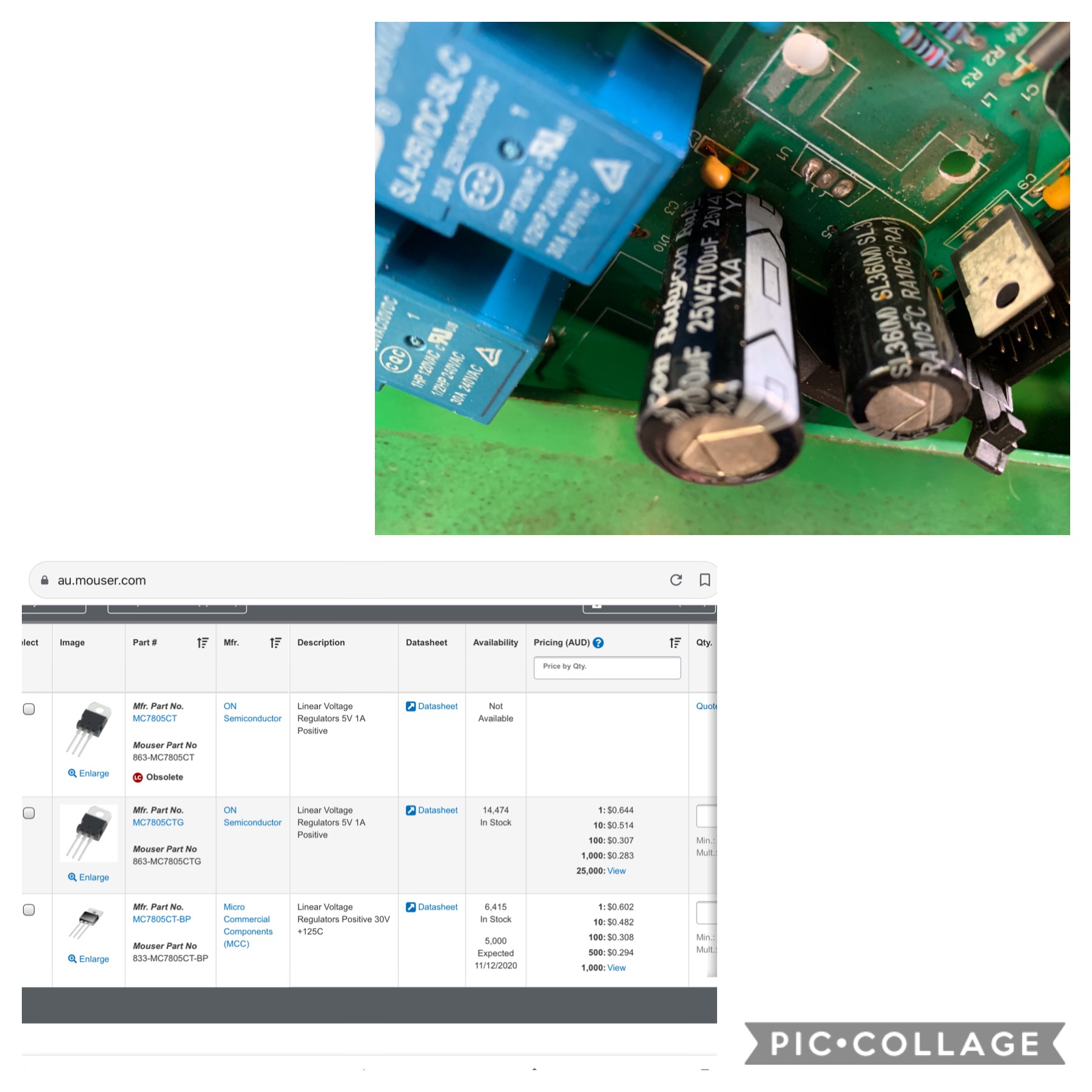

If you can tell us what's written on the capacitors near the transformer, and on the regulator that is on the heatsink near the capacitors, we can estimate the voltage of transformer needed. It won't matter if you get a transformer with a larger power rating than is needed, as long as the voltage is correct. The transformer that is damaged would have been 10 - 20 VA, so you can aim for somewhere around 20 VA. Larger transformers are bigger and cost more, but there isn't really any other downside. A 30 VA transformer is about £20 UK and weighs about 500 g.

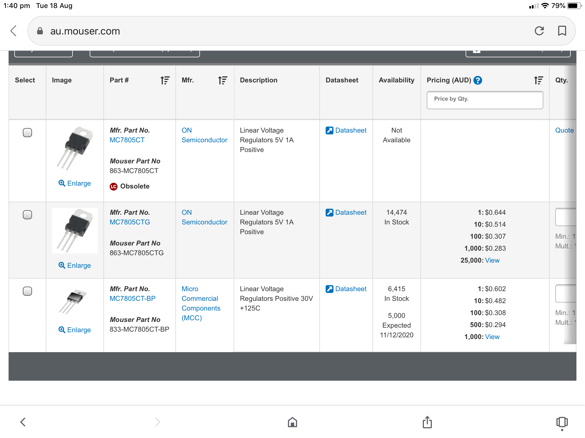

The relays appear to be 5V, so I'd expect a 7-0-7 or 9-0-9 transformer secondary would be suitable - but knowing the types of both voltage regulator ICs and smoothing caps would allow that to be verified.
a52ff494-f43e-4258-96cb-86f2e555de48-jpeg.126311
This voltage regulator and capacitors are in the photo
