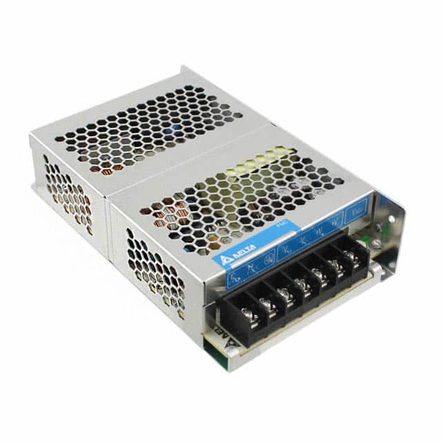

"Tranformerless" is a term we use to say there is no isolation from the power line. This is very dangerous.
This picture is a witching power supply. It has a transformer that runs at 100khz not 60hz. It is very small.
Supplies like this come with or without the metal cage.
I could not find very many "20" volt supplies. Every one makes "24 volt" and most can be adjusted down to 22 volts.
Input is 110/220 VAC.
This link should take you to a place where you can look at 100s.
https://www.digikey.com/products/en...ower+supply&pageSize=25&pkeyword=power+supply
https://www.digikey.com/products/en/power-supplies-external-internal-off-board/ac-dc-converters/133?FV=17d40094,17d40174,17d4003d,ii1|2211,ffe00085,1180042a,1180008f,118000b3,1180077b,118000c8,118000de,118000e8,118000f2,118009fd,11800100,1180014d,11800176,11800187,1180018d,11800193,118001a6,118001aa,1180002b,1180002f,118001ec,11800204,11800218,11800036,1180021f,11800234,1180025a,1180003d,11800273,11800288,11800362&quantity=&ColumnSort=1525&page=1&k=power+supply&pageSize=25&pkeyword=power+supply
