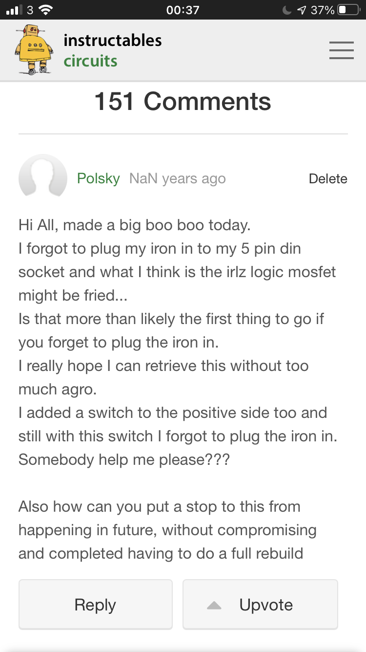

Please see link to a project I have built.
All was going so well until I forgot to plug the soldering iron into the 5 din socket.
Arrrrrgghh
It started to smoke a little and I’m sure it’s the irlz logic mosfet.
Urgently could do with some assistance

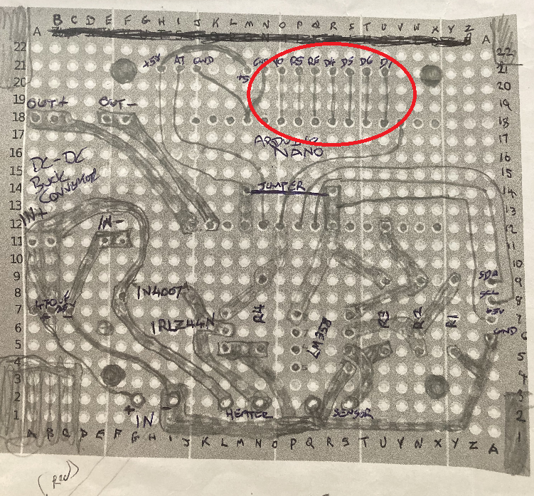

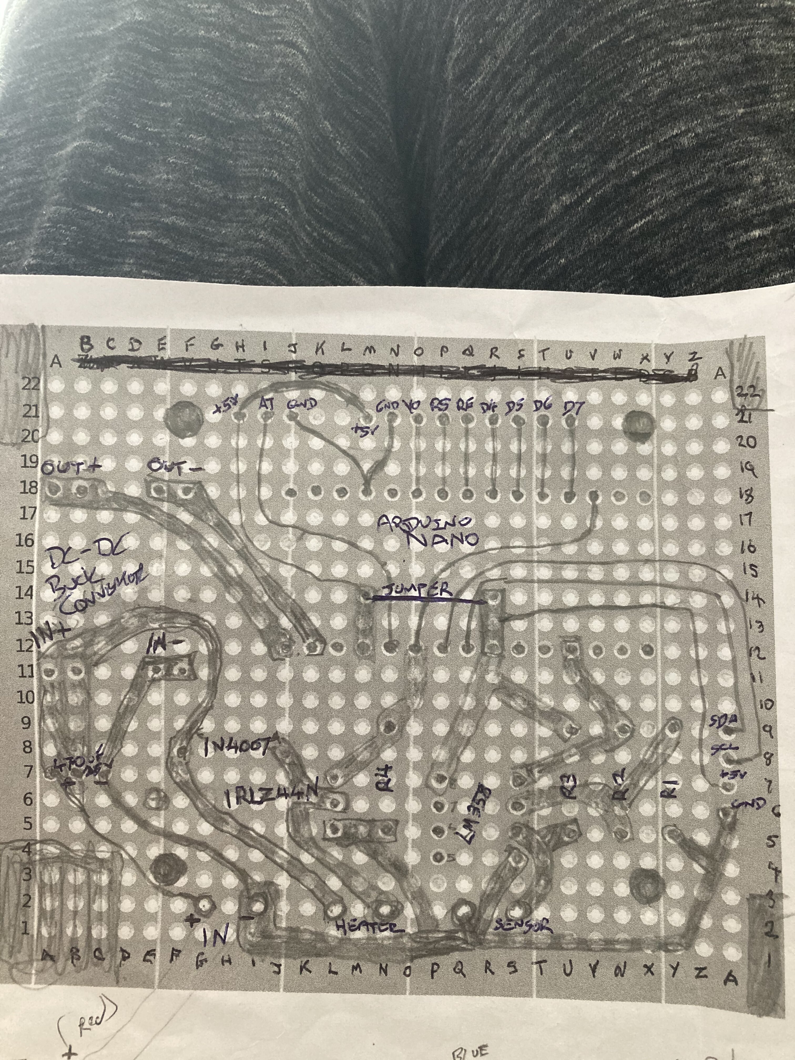

Not sure if this helps but this is the setup I have drawn up and followed to the wire.
Unless I’m missing something i.e. an I correct connection then I’m baffled

The only other thing I can think of is is the display and opamp circuit together are drawing too much current for the arduino 5V reg to handle?
If the display has a built-in backlight it may draw significant power.
@Music manager
They are connected from the Arduino to a 9 terminal connection point, which then connects to the LCD display, the 3 terminal connection block to the left connects to the POT, and then the other 4 terminal connection (which is down the right side) connects to the I2C in the LCD
OK .. .. .. .. well I think that's where confusion arises .. .. .. .. mainly due to the Instructable .. .. .. . but partly because using the PCB layout means thinking 'upside down' !
I suggest you compare your board with the printed schematic to check .. .. .. .
I don't think you need the ' 9 terminal connection point ' to the LCD and the I2c connections - either / or ..
MM
@MM
I used the terminal connection as a terminal point for connecting relevant wires (i.e. +5v wires link and GND wires link.
I have an Arduino Nano (but looking at it now it is actually a Nano compatible) so wonder if this is the problem, although the board and connections look identical.
I set the buck converter to 6.5v as that is what it was calling out for but wonder if this could be the problem.
