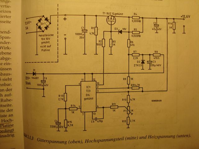

I checked my power supplies and could improve a few noise figures by adding bypass capacitors, they reduced the higher frequency noise sometimes several dB. (I used 0.1mF ceramic type).
The noise component was mostly in the 'fractions of a milivolt' range.
But my filament supply seems not to be ok, there I measured several milivolts ripple and I don't think this is right. I do not understand where that much ripple should come from, the regulation of the voltage regulator should be better, but I don't know what could be wrong. (see diagram included. By the way what can I use on a Mac to produce circuit diagrams, I am embarrased about the yellow pictures I have to upload...)
Uwe
Why do you have such a complicated voltage regulator that has its Mosfet barely turned on since its gate voltage is clamped too low?
Why not use an LM317 adjustable regulator and a couple of current-booster transistors if they are needed?
