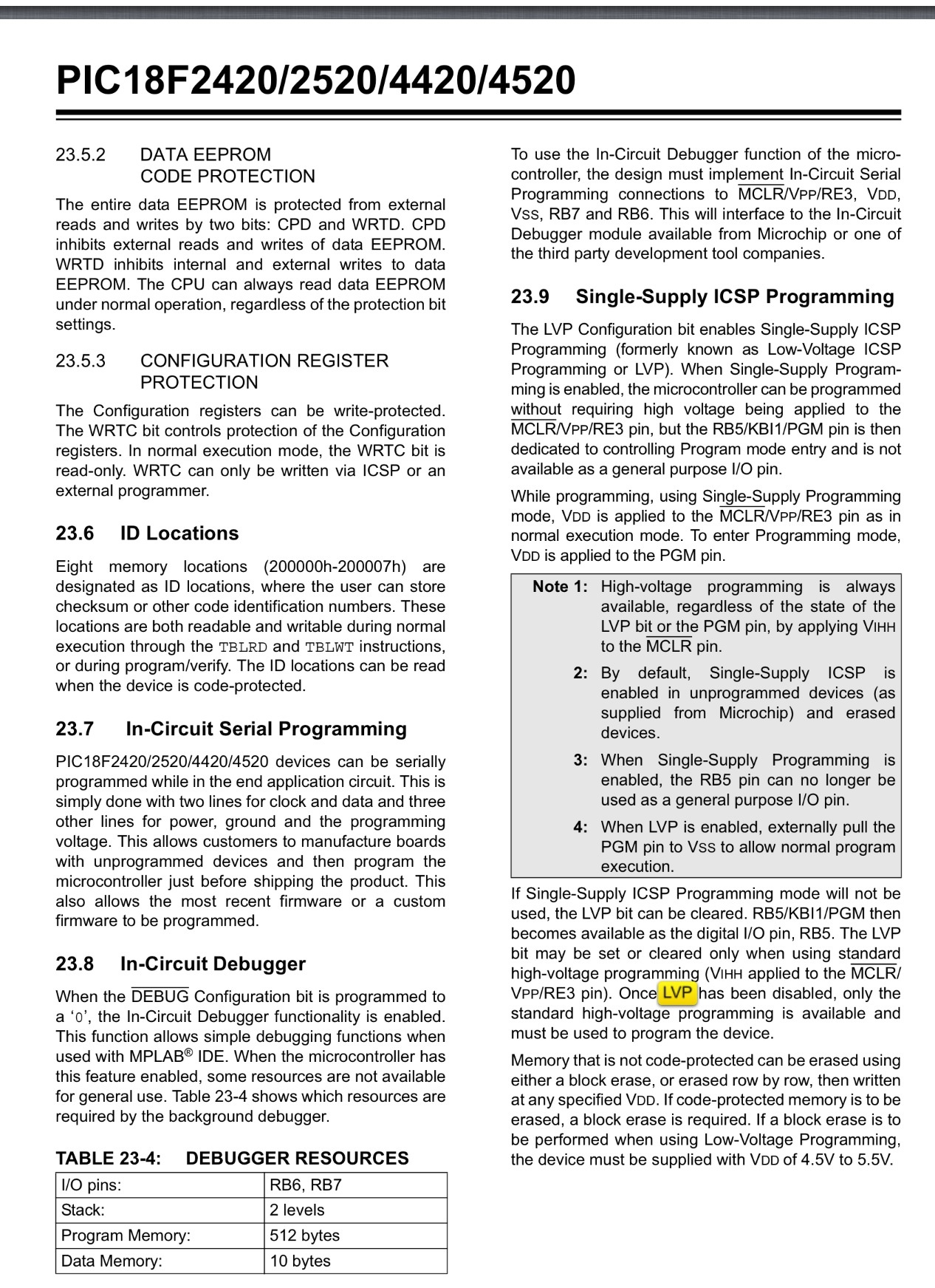

You're right. LVP is an absolute mystery. Nobody knows what it is or what it does. Well, wait. Maybe the data sheet says something.... Oh. It's not a mystery. Right there in the data sheet. Imagine that. Perhaps you should look at it sometime.
I'll save you the trouble of reading the data sheet and becoming confused. LVP should be off. This will always be true for you and most readers here.

Just in case you don't believe the datasheet is a good reference, here is the first item that comes up on a Goggle search:
PIC18F LVP. This is a good reference on the dangers of enabling LVP.
Just set it to off. It will be fine.
Well blow me over, 8volt programming?
I guess from now on just make sure the LVP is off
