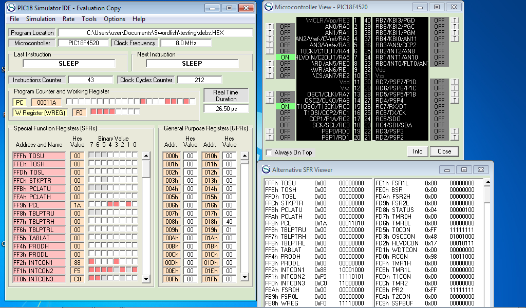

YES BUT the pic is not SLEEPING
been investigating WHY the meter shows 3ma durring SLEEP or supposed SLEEP.

but meter still shows 3ma.
Running Grahams INTERRUPT ON PORTB it shows .03ma on the 4ma scale

Here is what I am using for testing of code. BUT I don't think its going into SLEEP?
Getting weird happenings, led blinks then it won't until I disconnect then reconnect.
This should go to SLEEP?

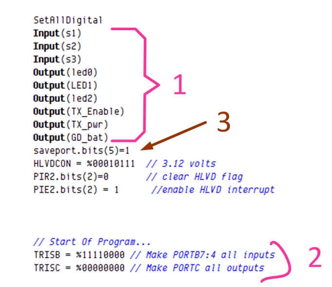

I'm glad to see you got the internal oscillator configuration properly set. Hope you understood Burt's clue.
As I have pointed out numerous times before, using the internal oscillator can be a real trap for those not paying attention to the details. The few cents saved on a crystal and a couple caps far outweighs the time and frustration of finding an internal oscillator setup/configuration error.
It's clear that your code is copy&paste(tm) from several different sources without an in-depth understanding of how the various pieces work. I'm saying this not as a criticism but in the hopes you'll learn something. Example and tutorial code is a good starting point to learn how something works. Usually, directly incorporating it into your code isn't going to work well.
The illustration below (from your latest code posting) shows several different programming styles, so it's clear they came from different places.
(see the attachment)
In the area numbered 1, you set up the various port pins as inputs and outputs using the INPUT() and OUTPUT() commands.
In the area numbered 2, you again set up most of the port pins as inputs and outputs.
Why are you doing this twice? Me thinks it's because you don't understand the code you have copied&pasted(tm). Either of these methods is equally valid but why use both? It can only lead to confusion and errors (you look at the code in one place and think it's set one way but in the other place it's set the other way). I happen to prefer the method of region 1 as easier to understand but either will work. Do note that if you like the method of region 2, you have not set up the outputs for PortA.
The item numbered 3 in the illustration is another area that will lead to (more) confusion. the variable SavePort is set to the upper 4 bits of PortB in the interrupt routine. It's always a good idea to initialize variables, and I realize that you've only coded for whatever action happens on PortB.5. Are you going to remember to add lines to initialize the other bits when you add the remaining code? Wouldn't it just be easier to initialize the entire byte all at once?
SavePort = 0
is much simpler and easier to understand than 3 separate lines initializing separate bits spread all over the place.
LVP - What is LVP and why would you want it enabled??? Hint: You don't. But understanding what it is might prevent mistakes in the future.

Oh I forgot the saveport.bits(5)(#3) was used just for testing portb5. No reason to get more clutter than need be. Heaven knows I have enough clutter already.
Did I not post something there about tried code in sim your HLVD is not working how the hell would you no.

I show you what happens in sim it does nothing nothing nothing and if something is happening your running the wrong HEX the wrong HEX.........
