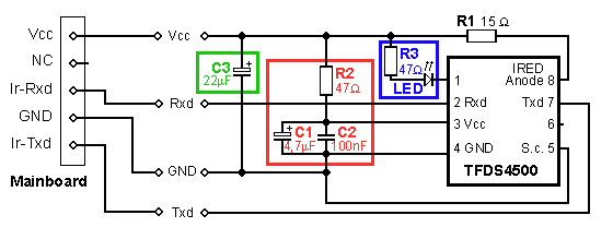

The comparator is a part of chip for signal conditioning.
See this circuit of TFDS, it's same as HDsl...

Well the only way I can get my hands on either the HSDL 1001 or the TFDS4500 is by ordering from the US/Germany. I am more inclined to use the HSDL 1001 cause it has the LED's built in. I'm not really sure how any of them work though.
Could someone run through how to MAKE the HSDL? cause it seems a bit of a waste, its going to cost more to buy it and ship it to Australia than to make it.
Thanks in advance, :)
Is there a way to make the TFDS i have the product information from that vishay telefunken website, but I don't knoe what comparator to use, or what the 'driver' is.
