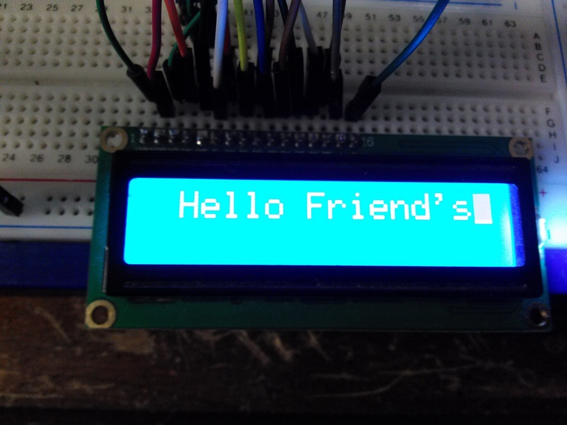

How to write string on specific line
void PutMessage(const char *Message)
char i=0;
while(Message[i]!=0)
PutMessage(Message[i++]); <<------ LOOK AT THIS BIT!!!!
LCD_Data(Message[i++]; //send it to the LCD!!!
He still has his strings in RAM so it won't work.
Yes... I have sim'd it... The const qualifier is correct... He is just calling the wrong function... The compiler is now whinging about a recursive call...
The keil compiler automatically treats that declaration as constants..
Yes... I have sim'd it... The const qualifier is correct... He is just calling .
I think You were just telling this

//Function to send string to LCD
void Putch(const char *Message)
     while(*Message != 0)
        LCD_Data(*Message++);
    Putch((const char *) Message);
void LcdGoto(unsigned char x, unsigned char y)
    x += 0x80;
    if(y==1) x+=0x40;
    LCD_Command(x);
void main(void)
      LCD_init();
       while(1)
          LcdGoto(1,1);
          PutMessage("Hello");
          LcdGoto(1,2);
          PutMessage("Forum");
Like this
You are printing both string on first line while I was printing first string in first line and second string in second line
You just set which line you want it's that easy.
You need to change to,
    while(*message)
        Putch(*Message++);
Or, a little longer but easier to understand
    while(*Message!=0)
        Putch(*Message);
        message++;
Edit, looking at the link Ian posted earlier that may need to be void PutMessage(code *Message) - the link isn't exactly clear.
