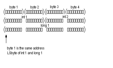

In C you should be able to create an unsigned long ( well 8 of them really ) this will be your group of LED buffers... Then "buffer <<=1;" will scroll the data right.
There is a useful feature in C, which is really underused.. Its a union. This is a data structure in which all the elements are contained within the same data space.
This way when you shift the long, the bytes ( which become your buffers ) are automatically aligned.

You have decided that the original plan of row scanning is a better option.... 32 bits is an unsigned long .. You need to scroll the long left or right... AND you need to feed the data 1 byte at a time..
This is why its easier to do this off screen... (and a lot easier to do columns) Scrolling the buffer is simple... "buffer<<=1;" scrolls the buffer 1 but you have 4 buffers in a line so using the full 32 bits will make it easier for you...

This is advanced stuff.... I really can't write another routine... You CAN'T use an unsigned long You would need to re-write the whole thing.... The suggestion of using a union is not going to help you until you can grasp the concept...
