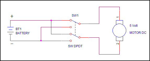

So based on your question here is the circuit:
The switch is a SPDT (Single Pole Double Throw) common switch carefully chosen to handle the current requirements of the motor. Oh yeah, not shown is the switch has a center off position because many motors hate to go from forward to reverse instantly.

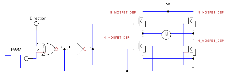

How would you turn a 5V DC motor both clockwise and anticlockwise ? I am also looking for a circuit diagram to explain this.
This H bridge will give you control of the motor direction and you can control the speed with the PWM. If you use a microcontroller then you can drive the mosfets gates directly.
