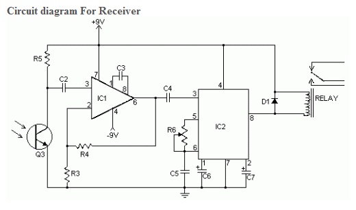

hi
i have problem with my transmitter and receiver circuit. This is my transmitter and receiver circuit diagram. Can someone give another or similar circuit diagram that can work and run correctly. Please. :(
mohd, start your own new thread with much more information and you will get more useful responses. Your diagrams don't have any values filled in and you haven't stated what it is that you're trying to do.
