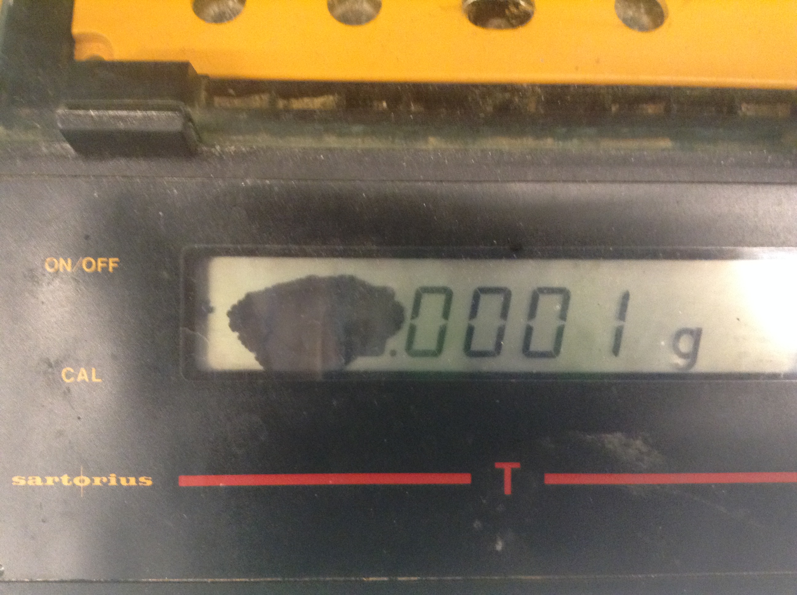

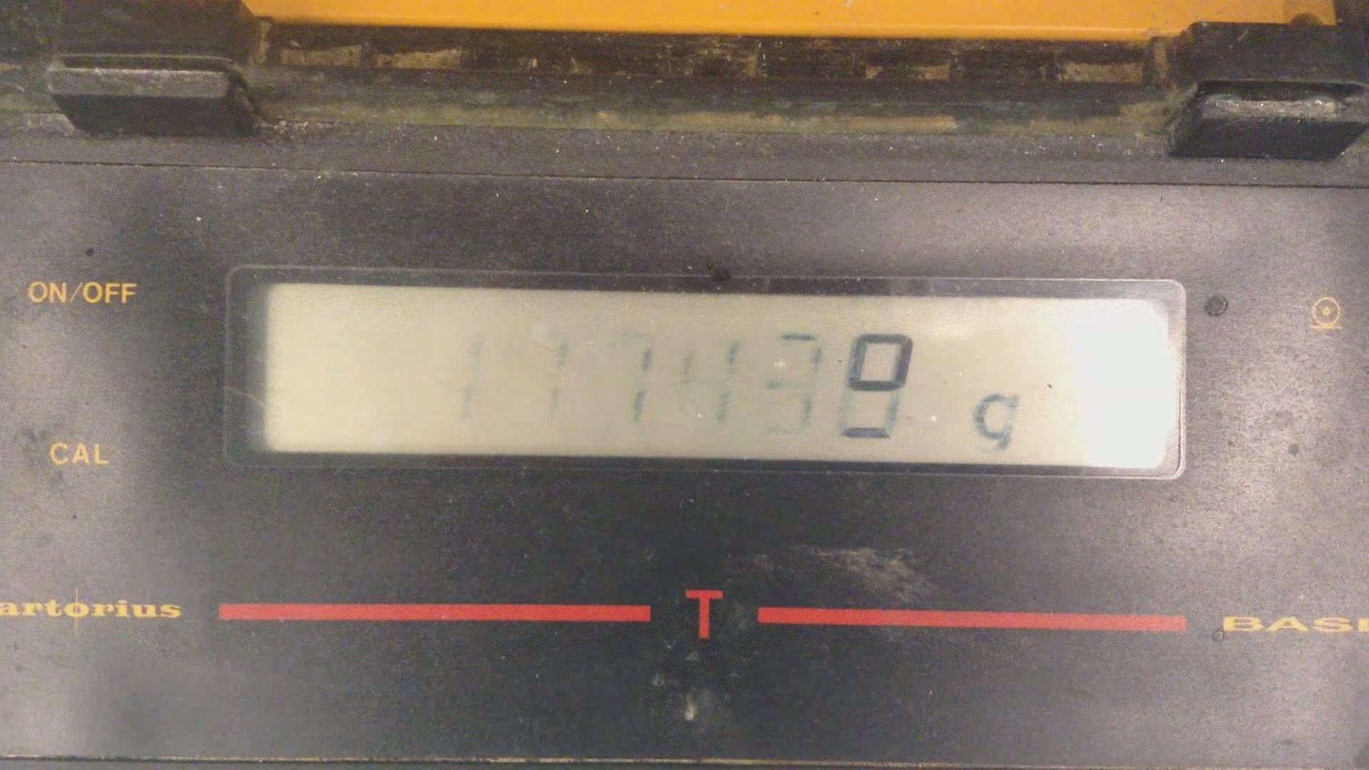

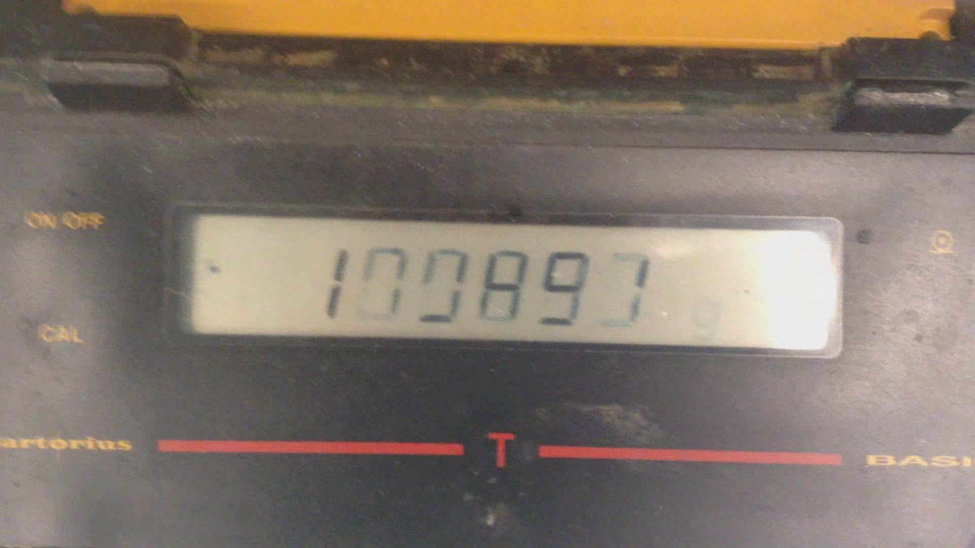

Our two Sartorius LCD FKF 2SS03 for our lab's temperature controller have the following problem:
One of them always flash as attached Fig.1 and Fig.2 show; another one the area near cracked surface accumulates the black
liquid crystals as attached Fig.3 shows. Does any one know how to repair them?

Cannnot be repaired, will take the replacement from manufacturer as it is not a generic type : needs the 'g' and perhaps other characters on it.

The black-out version is a lost cause.
The flickering dim one MIGHT be rejuvenated by taking it apart - carefully.
As you remove the glass, there is a foam "zebra connector" that brings power to the circuit on the glass. The zebra connector has strips of conductive carbon embedded in the foam and non-conductive strips. That way, when the foam block is properly placed, the circuits on the glass are properly fed from the PCB. Take it apart, hope the glass is fairly clean, clean the circuit board with clean water and soft Q-Tips or cotton balls or wood tongue depressor sticks/toothpicks. Make sure you do not scrape so hard that you pry the copper from the circuitboard substrate. Gently wipe each side of the zebra connector with distilled water. Clean the glass display with distilled water (where the zebra connector touches the glass).
Let everything dry well (overnight) and then reassemble.
Good luck. When you open it up, there may be big patches of green copper corroded PCB oxidation. Try not to rub this off too much. The little bit of copper metal may be barely holding on to complete the circuit. Be delicate and remember that crud/corrosion with an electrical connection is better than perfection on cleanliness with broken connections.

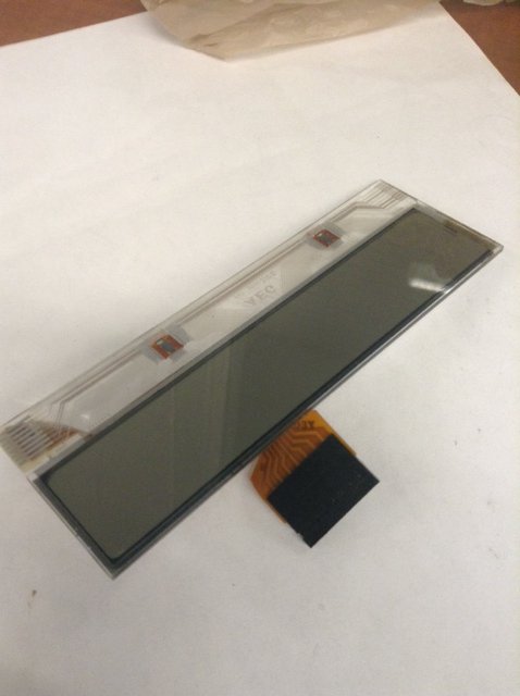

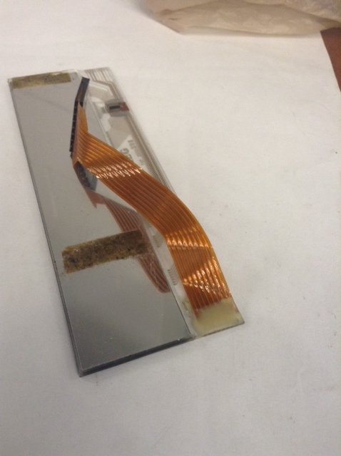

It seems that two glasses sheet are glued together as attached figs show. Can I take apart it directly using small straight screw drive? What kind of glue I can use for assemble after cleaning?
No, do not take it apart. If it is sealed, the glass is not the problem. Look at the connector and the copper traces on the PCB going to the connector m
This display looks pretty good or as good as it is going to get. Make sure the connector block makes firm connection to the connector block on the pcb. Make sure the pins on the pcb connector are clean and free of corrosion. Use a soft pencil eraser to polish up the copper or brass pieces.

I have done as your suggestion. Now when I power on the balance, the LCD screen shows in seconds then become dim and disappear. How can we explain it?Are there any other methods I can use to fix it?

Make sure it is dry - check all the pcb traces going to/from the pcb to make sure there is an electrical connection. Sometimes you have to add jumper wires across corroded copper traces to complete the circuit.

In the same balance, the black-out LCD shows data well except the black area that cannot be read. The LCD without crack still become dim after I clean it with pencil eraser. Perhaps I need clean the pin slot of the connector to PCB and use hair dry to dry all area as some youtube video show for fix the LCD for calculator?

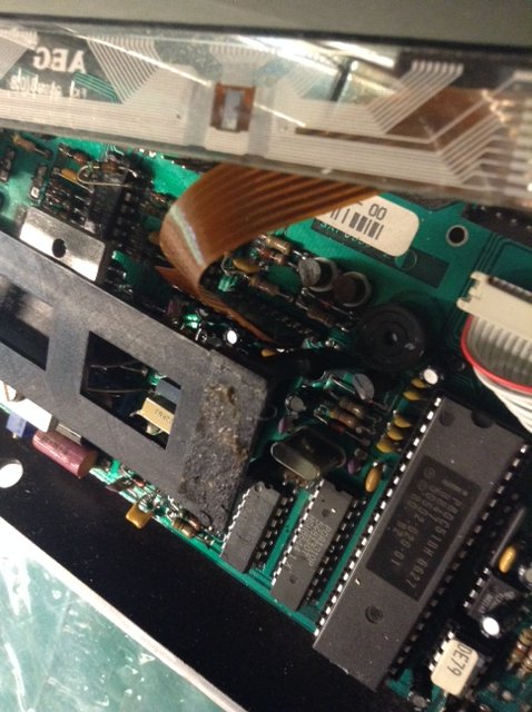

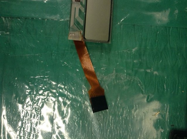

I cleaned the cable and slots of connector to pcb using electrical contact clean liquid, pencil eraser, needle and hair dryer (As Fig.2-3). The black numbers of LCD showed when LCD was switched on and then became thin and disappeared. I tried to disconnected and reconnected the connectors to PCB in fig.1 when all board was powered on, and got the same results. I am not sure the slots of connector is cleaned enough or if I should change the cable. Is it possible the replace the cable with the one attached to the cracked LCD?
