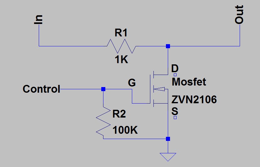

Raising the Control gate to 5v forces the output to ground. I chose a ZVN mosfet but I am sure there are better.
I guess the In and Out in your schematic is the analog signal in my schematic that's connected to the driver. Not sure about the Control input in your schematic. Could you please explain about that? I am willing to try anything at this point to get this issue resolved.

In audio amps, it;s customary to use a FET that will short the imput to ground for the power-on mute system. as long as your circuit can stomach a short on the line, then that's a reasonable way to get zero.
A FET to ground at the input you want to be zero.
Another option is an analog switch or MOS relay.
