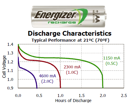

Something is wrong with your four AA Ni-MH cells in parallel. Maybe they are poor quality or maybe they are not fully charged.
The graph on Energizer's website shows that a single cell has a voltage that is higher than 1.3V when it begins with a 2.3A load then the voltage drops to 1.2V for most of its discharge.
I didn't find the original Ni-Cad cell on Sanyo's website.
