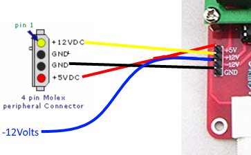

That function generator needs +5, +12 & -12 volts plus ground. You can get all of those from a PC power supply. You need those voltages before you can use it properly.

The voltage is up towards 24V p-p (due to the +/-12V supply - but the current is very low.
An audio amplifier would increase the power capacity.
As Nigel indicates, you do not have the -12v. What you require for that is to take pin 14 of the 24 pin ATX connector and connect it to your -12v pin. You are looking for a blue wire which is next to 3 orange wires at one end.
Thank you! I am searching for it.
