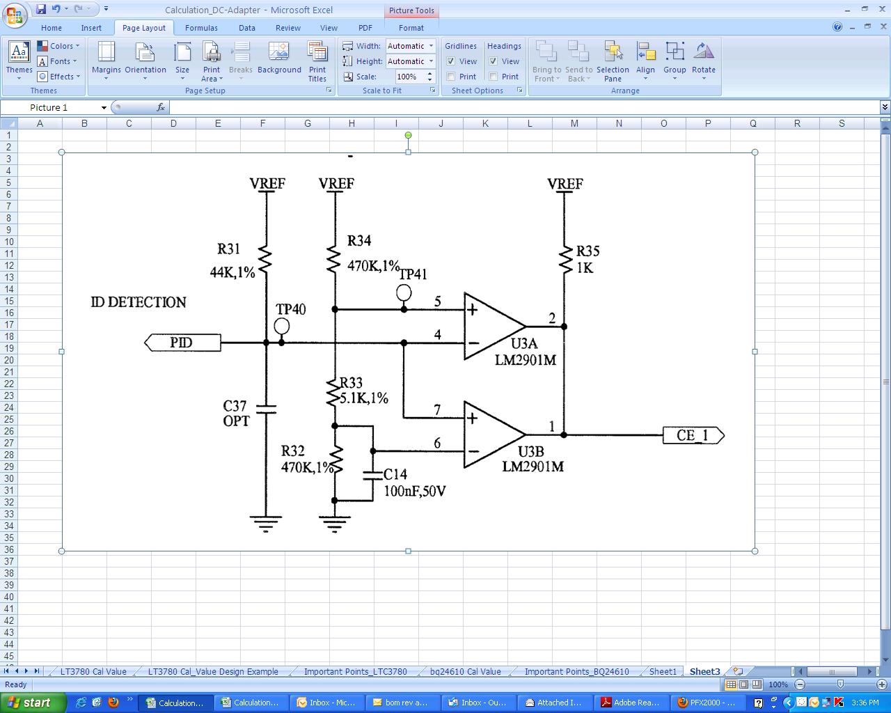

I attached the diagram, in theory it should work I guess....
Would like to get a good advice.

Your posted circuit is as Roff suggested a Window Comparator. The window is determined by R32, R33 & R34. The upper limit is on pin 5 of U3A (Test Point 41) and the lower limit is on pin 6 U3B. Anytime the voltage at test point 40 is within the window the output (CE-1) will be high. R31 serves as half of a voltage divider based on what the PID resistance is to ground. What doesn't work about the circuit? As drawn it should work fine.

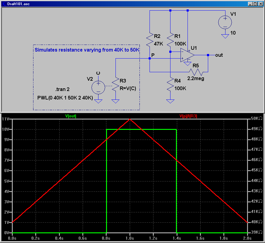

Here is simpler way to do it. Single opamp or comparator. Has settable amount of hysteresis.
Note how LTSpice can model a time-varying resistance: create a time varying voltage, and then make the resistance vary in step with the voltage. Red trace shows the varying (sensor) resistance. The green trace is the output. If you want the output to go the other way, swap the position of R2/R3.
As shown, the cutin resistance is 48K, and the cutout resistance is 46K.
