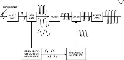

So is there a way to make an AM transmitter?
Ignoring the frequency response and assuming it was adequate, whatever you modulate an AM transmitter with, you would get the same back, out the receiver.
SSB transmission is based around frequency mixing, often a similar two stage process as I described for audio but using a fixed radio frequency for the first stage, to do the sideband selection filtering before mixing again to the final frequency.
eg.
They call the first mixer the "SSB generator" in this diagram. The sideband filtering often at around 10.7 MHz for VHF equipment, as narrowband quartz filters are readily available for that.
Think of it as a reverse superheterodyne receiver, with the transmit signal generated at the intermediate frequency and mixed to the on-air frequency then amplified.
