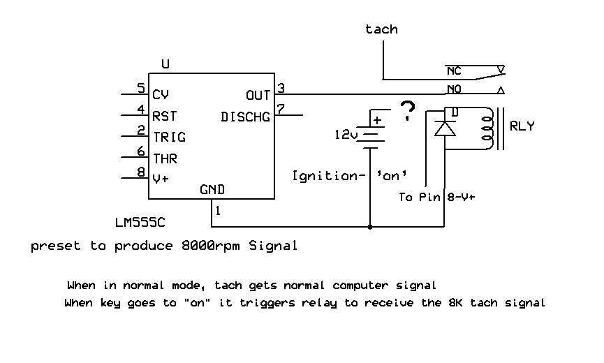

I want to make my 20 year old car do a Tach needle sweep you see in new cars. I have made a Freq generator that outputs exactly 8k rpms.
I just need to have a relay switch this feed with key on, but I am struggling with how to have it go off in just a few seconds to go back to normal operation.
Wasn't sure if a typical R/C circuit would dissipate evenly or quickly.
Goal is to turn car to Ing-'on', tach then sweeps from 0 rpms to 8,000 rpms then back to '0'. I have not physically timed this, but I am guessing 2 seconds it takes to go from 0-8,000-0. I can time it and adjust accordingly. So the time needed is really to get it to the 8000rpm mark, then the power can be removed so it can drop back down to 0 rpms
Any recommendations of what to use would be very helpful. I have started a simple schematic attached.
Stu
What frequency is it and does the tach slew at the desired rate?
The tach needle "sweeps" when frequency is applied and is rather fast...Albeit I have not timed it. It snaps back faster once frequency signal is removed, and just a hair slower on the rise to 10K.
10K RPMSs = 500HZ. Every 100 RPMs = 5HZ So at 8K RPMs I am at 400HZ. I already have a pre-made HZ generator set static (by resistance) to 8K or 400HZ. So once there is power (12v) to the frequency generator it will immediate sweep the tach needle to 8k RPMs. Once power is removed it will snap back to '0'. So I need to have 12v power to the Frq. Generator just for a few seconds.

LM555 can be reset by grounding pin 4 it need p+ to operate so get another lm555 use as one shot 2 sec monostable. That should do it.
also pin 5 if drugged montarily to gnd will do it. A capacitor f/b from the relay can be used and of course set up your timer .639 rc
I still am not quite sure how to design this to go off in 2 sec. Can you give me a circuit design? Here is the 555 timer I have made that produces a static square wave output of 400HZ (= 8000rpms). I may change it to output 10K...not sure yet.
So If I can make this circuit shut down after 2 seconds, that would work I am sure.

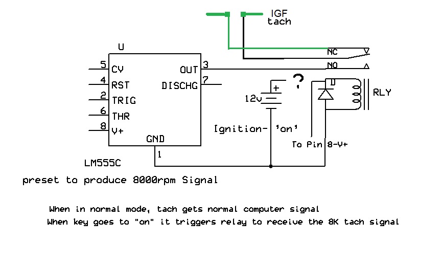

The instruments goes hot on "ign on" and stays on through cranking. The tach signal "feed" would be cut and looped to the 10k input signal, then back to normal operation after 2 seconds. I suspect with the 10K tach feed from my 555 with be pretty snappy.
This drawing isn't totally correct as I am not quite sure where to interject the timing circuit. It does need to go off at the relay otherwise the relay will not go back to N/C.
Are you stating that I can use the CD4060 for the square wave generator AND the timer all in one chip?
