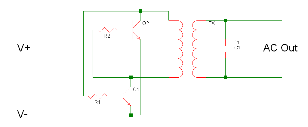

The simplest and crudest inverter design you can get that will work for small loads is this.
Its a free running oscillator of sorts and the capacitor on the output is going to dictate what frequency range it runs at.
All you need for 12 volt opperation is a basic 18 - 20 volt center tapped transformer, two transistors or Mosfets, two resistors and the AC capacitor.
You will need to select the right value for the resistors depending upon what gain your transistors have. This circuit does work with Mosfets and the resistor values are much higher for voltage controlled switching devices so the overall circuit does get a little efficiency boost when using them also.
The AC capacitor needs to be sized for the transformer and the load but the over all circuit does give you a fair sine wave output but the frequency and AC voltage does drift a little depending upon the load.

I'm assuming your pump is 230VAC is that correct? If that's the case at 5 watts an inverter is still going to be able to supply lethal currents at a high enough voltage to get it going, or at least shock you stupid if there's water involved.
If correctly designed it does have the advantage of being isolated from earth so you have to touch both wires to receive a shock.
Also, if the current was limited to a maximum of 25mA, it would be unlikely to give a lethal shock, although it certainly would be a nasty shock.
If properly fused, ideally with an over current crowbar circuit, straight mains isn't that dangerous.

I tried powering it up with a 12W inverter made for CFL lamps. It didnt work. The CFL lamp inverter is probably a square wave inverter.
That wouldn't work for the following reasons:
  • Incorrect voltage, CFL lamp inverters output a constant current, the pump requires a constant voltage.
  • The frequency is far too high, CFL inverters work at >20kHz, the pump requires 50Hz.
  • Not enough power, the motor requires 25W and the inverter puts out a few Watts at the most.
