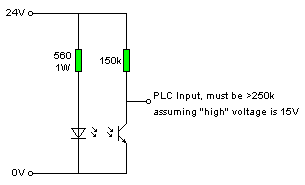

Here's an idea.
This assumes the PLC input has an impedance of more than 250k and voltages over 15V are considered to be high. Of course, if the PLC input impedance is much higher the "high" voltage can be nearer 24V.

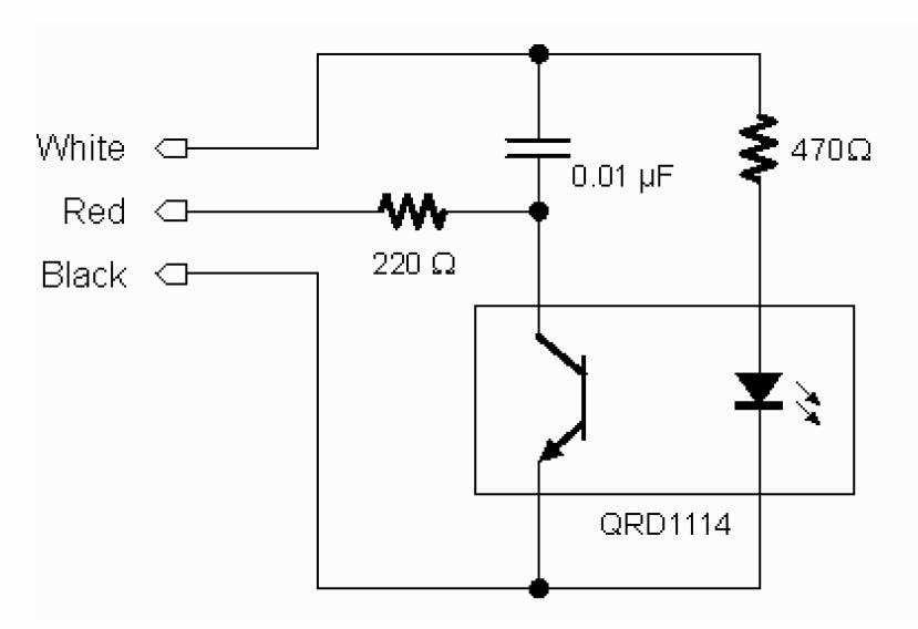

I think that using transistors will be too much of a hassle and it may be easier just to replace the sensor. Sorry that I didn’t provide details earlier. My PLC is a Panasonic FP0-C16T PLC with digital I/O points. Input is 24VDC, output is 24 VDC, 0.1A. Sensor is a Parallax QTI sensor.
The PLC didn’t specify the current requirement for the input. I was wandering if there are other possible issues with this setup.
I have uploaded two schematics: one is the original sensor and the other is my modified version. I have added a 10K resistor between Input(Red) and 24V(White). This is to make the sensor signal output digital. Since I’m supplying 24V to the sensor, I have changed the 470 ohm resister for the IR emitter to a 2.4K one.
As for the current sensing or voltage sensing inputs, I have no idea which one I’m using. However, I believe my PLC has only one type of input.

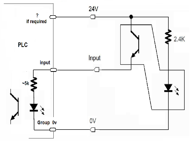

The PLC input parameters are specified on page 18 of the document in the PLC link.
The PLC digital input is an opto-isolator in series with a 5kΩ (approx) resistor.
Yes there are, the sensor is incompatible with the PLC input as it comes straight out of the box.
As you seem to be happy modifying the opto sensor, wire it up as shown in my attached sketch. That should do what you want. No extra transistors needed.
Good.
Look at the table on page 17 of your link, your PLC has 8 digital inputs and 8 digital outputs.
In the context of this thread, the inputs are "voltage sensing".
