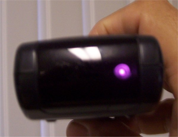

The simplest way is to point the remote into the lens of a digital camera.
If the remote is transmitting when you press a button, the light will be visable on the screen of the camera.
Should look like a flickering light.

That is clever! Thanks!
remote-jpg.32160
It is working with my cell camera too! And the light is flickering.
She said that she changed the batteries but they were comming from another remote that was working. I will put new batteries and see.

It is working fine now!
New batteries plus a good cleaning of both the remote control and the DVD unit IR windows fixed the problem.
