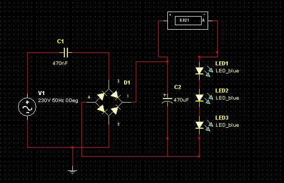

May i know what kind of led you are using? Why the need of 100mA? A typical 3,5 & 8 mm led can be driven at 20mA for best performance. High powered led like luxeon I drive at 350mA and III series at 700mA. For high power led, using capacitor methods is not advisable.
Typical commercial 240VAC led lightnings without transformers are all driven at 20ma. Previously, i post this diagram before. You can refer to it to light up your leds without the fickering cause by direct AC. For the 470nF, get those supperssor-type. Voltage rating should be above 400VAC for safety. The bigger the voltage rating, the bigger the cap size.

VictorPS said:
Thank for your schematic, I got your idea.
