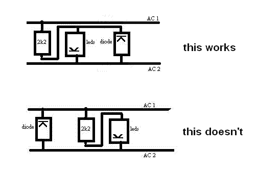

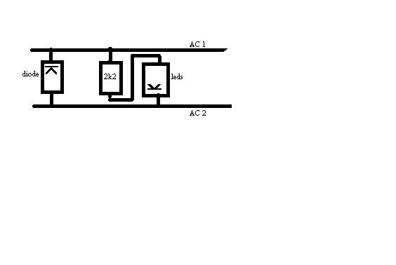

connect a series 2k2 resistor and a diode in the other way the leds are. if the leds are from "+" to gnd then diode must be from gnd to "+".
(gnd is one hole in AC and "+" is the otherone)
the diode must take the voltage so use 1n400X series. It is there so that the reverse voltage wouldn't kill your diodes.

Looks at your circuit diagram again. If you connect AC1 and AC2 to 240V, prepare to put out a fire. :twisted: :twisted: :twisted:
Yep it aint looking good for the "protection" diode.Conecting an diode directly to the mains is going to totaly fry it
yep.bye bye diode and probobly bye bye your house.

well, this schematic has always worked for me. nothing had birned down (jet). Only thing different is that in setead of this "protection diode" i used anothed LED with a resistor.

Here's what we're trying to tell you (ignoring the issue of wasted power):
