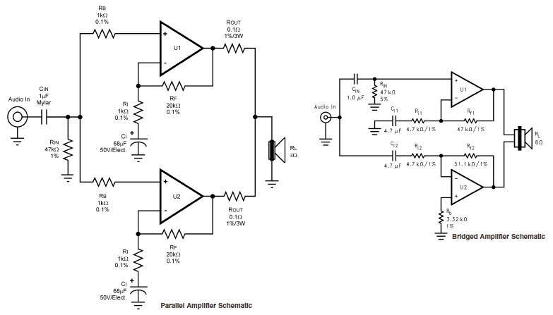

Don't you know that the output impedance of a modern amplifier is extremely low? 0.04 ohms or less. The spec for it is called "The Damping Factor" and some amps have a damping factor of 1000 so their output impedance is 0.008 ohms. The extremely low output impedance damps resonances of modern speakers.
The applications note for the LM3886 amp shows how to parallel them for more output current so they can drive more current into a low impedance load. Each amp has a series output resistor so that they share the load even if their gains are slightly different (the recommended gain-setting resistors have a tolerance of only 0.1%).
The applications note also shows how to bridge them (completely different from paralleling them).
The applications note also shows 4 amps paralleled and bridged at the same time.

Well, what about Audio "Guru"'s illustration with two 3886s in parallel--that's from the application note. Apparently they don't destroy each other.

In theory for identical amps in parallel the output impedance will be the output impedance of one divided by the number of amps. But note that to safely parallel the amps you need to add a small resistor in series with each output (0.1 ohm in the example to avoid current hogging). Since this resistance is much larger than the equivalent closed-loop output impedance of the amps, then the parallel output impedance will be basically 0.1 ohm divided by the number of amps.

It's caused by the small difference in output voltage between the amps due to tolerance of the gain resistors. (Notice that they use 0.1% resistors to minimize this difference.) Because of the low output impedance, the amp with the higher voltage will try to drive a large current into the amp with the lower output voltage (basically the voltage difference divided by the sum of the equivalent output impedances). Thus a small output resistor is added to minimize this.

Each source (in this cause the amplifier) can be assumed or modeled as a voltage source in series with a resistor (this resistor determines the current and voltage limitation of the output of the source). by paralleling 2 amplifiers you just can convert a Thevenin to Norton conversion and see that you will have a current source with a resistor in parallel across it having a resistance of halved (Req=1/R1 +1/R2) with another norton to Thevenin you'll see that the equivalent series resistor would be halved which means that the source is able to give you twice current than when it was alone....
My example of the paralleled LM3886 amps allows more output current so they can drive a 4 ohm speaker at a higher power (about 110W).

I also mentioned the same application, but without the reference - it works by only using two chips in parallel, by been fairly accurately duplicated chips, and by using low value precision resistors to share the mismatch.

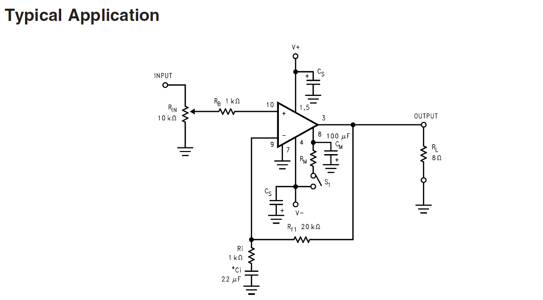

I want to try 10 separate LM3886's for the job.
I have got a question regarding the input connection for 10 LM3886's. The schematic which I want to use is in the below pic.
The question is that Can I connect all inputs of the LM3886's directly connected together or there is any trick I should do for doing so?
connecting all inputs then is the total input impedance of the LM3886 circuit becomes 1/10?
