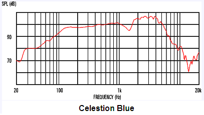

Here is the frequency response of a typical 12" guitar speaker, the Celestion Blue. It is no where near hi-fi since it sounds like an old AM radio with no bass and no highs. It has a screeching peak from 1.8kHz to 5kHz.
If two are connected in series like is normally done then the damping is reduced so the output at the resonance of about 75Hz is increased.
The rear of the enclosure is completely open unlike a properly designed hi-fi speaker.
What has that got to do with professional PA systems?, which are essentially multi-kilowatt HiFi systems.

A modern amplifier has an output impedance of only 0.04 ohms or less. So it damps the boomy resonance and other resonances of a speaker. You don't want a speaker to sound boomy. You want the speaker to stop moving when the amplifier output stops.
With an identical speaker in series then the damping impedance is maybe 40 ohms or more at resonance so the speakers get almost no damping.
Maybe cheap little speakers in the ceiling of a hall don't matter about damping. Or maybe they sound better with poor damping.
