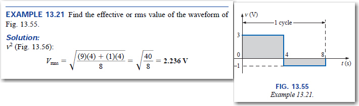

i would like to know how to determine the rms value of a waveform.
I have an example here, where I don't understand why is it like that?
Could somebody please explain to me?
I didn't get it why is it square root of {(9*4)+(1*4)/8}
I've read that the formula for the rms is: Irms = 0.707Im

Vrms=square root (V squared)
In your example (9=3 squared)
In your example 4/8= 0.5 (50% of the time the voltage is +3 and 50% of the time the voltage is -1)
The Vrms=square root(1/2*V1*V1 + 1/2*V2*V2) where V1=3 volts and V2=-1 volt and the 1/2 = 50%
Vrms=square root(3v*3v*50% + -1v*-1v*50%)
3*3=9 and -1*-1=1

thanks for the reply. In the RMS formula it states :
xrms = square root of { ( x1^2 + x2^2 +....xn^2)/ n }
what does "n" here stands for?
In my example: The number of "n's" are = 2. I would like to know what does it mean?
And why is the solution used the "50%" value?
Square rooting the weighted average of all the Voltage^2 that exist in one period is all it is. If you understand this one sentence then you shouldn't need to read anything else here.
50% is from the image you attached. 50% of the period is spend at one voltage, and the other 50% is spent at another voltage (4s+4s = 8s!) It was used because he is finding the weighted average (the times each voltage exists for per period is acting as the weights, and dividing by the total length of the period itself normalizes everything to a fraction/percentage/ratio).
rms-jpg.24745
THe 9 comes from (3V)^2. The 1 comes from (-1V)^2. So those are the two voltages that exist per cycle. And you are trying to find the mean of the squared values, so you have to square them. THen you multiply each by the amount of time that it exists for in the period (it happens to be 4s each for both voltages in this case) and divide it by the period (which is 8s) to find the fraction/ratio per period that the voltage exists for (or you could just multiply it by the ratio directly if you know it off hand which in this case would be 0.5 for both voltages). Then you take the square root of it all.

What you're really doing is you are squaring each voltage level that appears in one period of the waveform, and then putting them into a weighted average. ANd then you take the square root of the whole thing. Put another way, you are taking the weighted average of the voltages squared. THe "weighted" part of the average is with respect to the percentage of time that each voltage level takes up in the period.
If you do it in terms of time, you have to divide it by the period to normalize it and make it a weighted average:
THis is the weighted average
All that is missing is square rooting the whole thing since you are finding the *ROOT* of the Mean of of the Squared. 'x' would be your Voltage^2. 'w' is the time that the voltage exists for in the period. ANd since the denominator is the sum of all the 'w', it is equal to the period itself. Of course, you can totally skip multiplying every Voltage^2 by its corresponding w, and then dividing everything by the period. You could just do all that beforehand and multiply each Voltage^2 by the percentage (fraction of each period that the voltage exists for).
sqrt{ [ (1st voltage level)*(1 second) + (2nd voltage level)(2 second) ] / (3 seconds) }
or you could do the (1sec/3sec) and (2sec/3sec) operations first to find the percentage per period that each voltage takes and go straight to percentages:
sqrt{ (1st voltage level)*(33.3%) + (2nd voltage level)*(66.6%) } / (100%)
but of course, in actuality you woudl just go:
sqrt{ (1st voltage level)*(0.333) + (2nd voltage level)*(0.666) / 1}(but we never write the 1 obviously)
You see how the 33.3%, 66.6% and 100% appear in the same places in the eequation as 1sec, 2sec, and 3sec? It serves the same purpose. THe denominator is equal to all the weights added together (33.3% + 66.6% = 100%, 0.333+0.666 = 1, 1sec+2sec = 3sec) because it's not the absolute amount of time that matters, it's the fraction of the period that does.

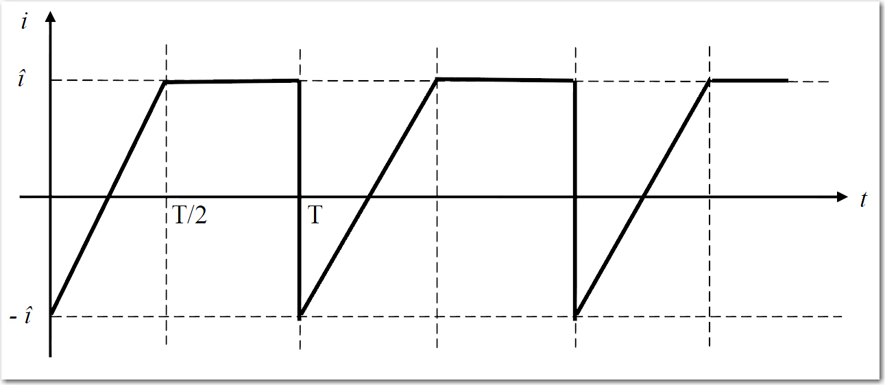

hi again,
I'm having a difficulty with triangular wave.
I have an example here and the answer is : square root of { 2/3 } * i I don't why the answer is this.
I somehow resolved the average value but the root mean square not. I always end up with the wrong answer.
Could somebody please explain, how it arrived on the answer:
square root of { 2/3 } * i.
Thanks again

Well, IMHO, I think that the integral form of the RMS value is much more reliable and easier.
RMS = sqrt{1/T * integral[ (f(t))^2 dt] }, where T is the period, and f(t) is the signal function.
In the case of this last picture, the wave is composed by 2 functions, so you'll have to split the integral.

The solution was this:
__
I^2 = (1/T) (T/2) (i^2/ √ 3 ) ^2 + i^2
____
I = √ 2/3 * i

You've mentioned that my answer on my another example is just a weighted average. I think I also performed the square root after.
From: I^2 = (1/T) (T/2) (i/square root of 3)^2 + i^2
To: I = square root of 2/3 * i --> so this one is not correct?
ps. thanks for the PDF File
The area for first half + second half of the square function is:
0.25Ti^2 + 0.5Ti^2 = 0.75Ti^2
divide it by the T to normalize, we get:
0.75i^2 = (3*i^2)/4
Take the square root of the whole thing and you get:
i*sqrt(3)/2
There must have been a typo with the brackets. So no, it doesn't seem right. But neither were you. I don't see why your 3 came in so early. THe reason it is there is from the 0.75 = 3/4 after you've added everything up.
SQRT[(1/T){(T/2)(0.25i/square root of 3)^2 + (T/2)i^2}]
I have no idea what is going on in the italics. THe bold, underlined part is totally out the window. It just shouldn't be there.
THe 0.25 is from the fact that the area of the first half of the period is 0.5*(T/2)*i^2. You can do it mathematically using the slope of the line, but I just did it visually. The negative half of the line is the same area as the positive half and since you are squaring it to make it all positive, I just flipped it to above the X axis, and from there you can see it takes one half of a grid square (and one grid square covers T/2 of the period).
