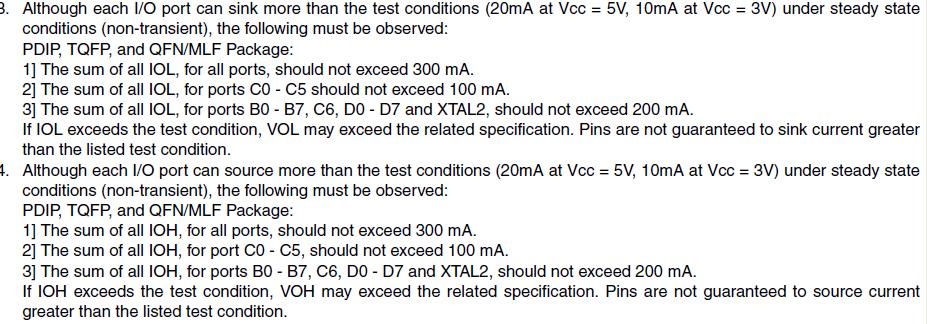

Okay, so I have this circuit of microcontroller, transistors to control lamps, ... There are 20 transistors controlled by 15mA. So the consumption (without including the IC) is roughly 300mA just for the transistors. The loads' supply are connected directly to 24Vdc. The circuit is fully functional on the 1st day but screwed up on the 3rd day.
300 mA is a lot to pass through a micro... even though most allow 20mA on a port pin (40mA sink on the ATMEGA16), the overall per port and the overall per device is limited to somewhat less than that. The ATMEGA8 can sink/source 300mA as it's absolute max, while the PIC12F683 is around 95mA. Read your micro's electrical specifications.

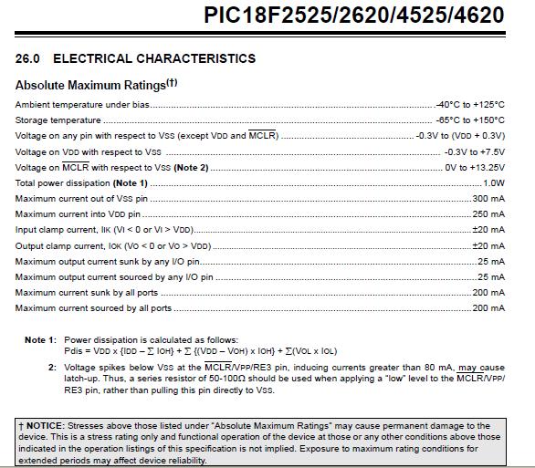

Yes, I placed decoupling caps beside mcu, caps on regulators as seen on the datasheet. Sorry but I don't know what's the max power it can produce. I used PIC18F4620.
here's what I do... go to digikey.com, type in PIC18F4620, bring up the part, click on the datasheet to open it up, click on sec 26, electrical specifications, and READ... (if digikey.com doesn't have the part, then microchip.com should have).
Amazing, if you are sinking the transistor gate current, you are borderline (which I doubt, since the transistors are hooked up to a 24V source/load). Since you are probably sourcing, you exceed max current by 50mA. Make that exceeded by 100mA, as there is a note "max current by all IO ports = 200mA." And by max current, I mean you can't have so much as an additonal pullup connected other than your transistor outputs.
This is probably why you are getting random failures... once you exceed the max current, all bets are off. You've probably damaged the micro... read grey box at bottom of attachment.

I think I have made bad calculations for the output current for microcontroller. I should have increased the resistance. I guess I played safe too much with opening the transistor. It was supposedly to be controlled with just 2mA my bad.
