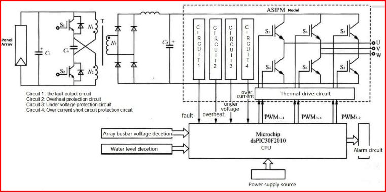

Is this something like your system block diagram?:
Are there contol set points that can be adjusted (since you said you've been "tuning" the system, I assume there are)?
If so, what are they?
I'm not sure why the current is increasing (free running the motor exceeds some rev limit?) but I'm thinking that monitoring the solar panel array's VDC level might provide an anomaly that can be exploited.
Hello
It's similar to what you have shown.
I don't have the intermediate converter.Panel goes direct to 3 phase bridge.
I measure solar voltage, current and motor current.
When motor stops demanding current, solar voltage increases and my algorithm reduces the duty of the inverter and vice versa.which reduces motor ac voltage.
I run the entire show on a Microcontroller.

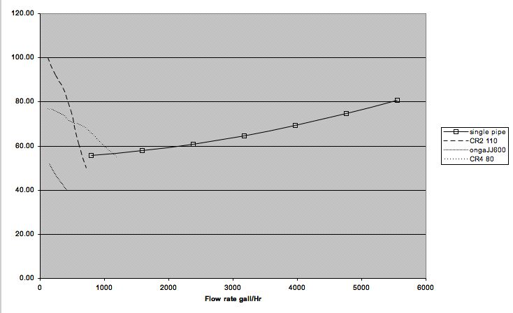

Abi,
attached is a simple example of where we have to go. To study your system, you need to get enough info to get a good picture of the operating characteristic of what you want to build.
For the pump we must have the maximum pump pressure. This will always be at the 'no flow' point. That is, the pump pressure when the outlet is blocked. Your data shows only one operating point (100 metre head at 90 LPM flow). Then we need to have an idea of the maximum flow. This is when the pump is operating with no restrictions on the outlet. In the attachment I have shown 3 'typical;' pump characteristics. These are the dotted lines at the LHS of the picture. They have been 'massaged' from some real pump data. The CR2 and 4 are Grunfoss multistage types; the Onga is an Aussie single stage pump. You can see the steepness of the multistage pump curves compared to the Onga pump shape. You can see how the CR2 would pump more water than the CR4 because one has 110 metre head and the other has an 80 metre head.
Because you want to run your pump over a speed range, we need the head/ flow characteristic curve, to be able to modify the typical characteristics at the 2880 RPM to other speeds.
Next on the graph is the pipeline (or load) characteristic. It shows how the load interacts with the pump. In this case, the load is a pipeline and the pump is located some 55 meter below the pipe outlet. If you extend the pipeline flow back to the vertical axis, you will find the pump pressure required to be developed BEFORE you get any flow.
In your trial to date you say you used a restriction on the pump to replicate the working pressure of the pump. However in that case your load is not exactly doing what you want. Your trial load will allow flow at almost no pump output pressure, whereas your system will require some significant pump speed to get water to flow. Your trial load will be a sloping line like the pipe line characteristic but it will extend down to the horizontal axis.
The depth to the water is needed. It is assumed that the bore hole will have a diameter at least that of the pump. BUT will there be an outlet pipe attached to the pump, and if so will this be a 2 inch pipe.
When the water gets to the surface, what piping is attached. Does the water get put into an above ground tank or dam or a water channel, or is is used to irrigate directly.
I looked on google and found a story about the Indian Government wanting to change 26 million diesel pumpsets for solar. I guess this is part of that program.
