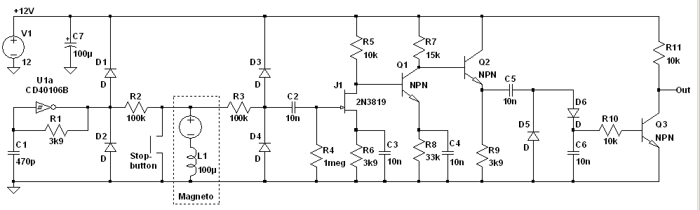

When the engine is not running, I would like to detect if the stop button is pressed. So basically I wish to detect whether there is a short between the coil terminals or not.
I have done a few measurements on the coil connected to the terminals. It seems that the resistance is only 1ohm. Since there is also resistance in the wires and also in the button, I'm not sure measuring for resistance is a reliable approach.
Could I somehow measure for inductance? I have a PIC available but don't know how I could use that to measure for inductance so I would like to hear your suggestions.

The dual magneto timer for my aircraft engines do this. They detect if the magneto points are open or closed by using the inductance of the primary coil vs the short circuit if either the points are closed, or if the magneto kill switch is shorting the coil. If you connect a DC Ohmeter between the "p-lead" and ground, you see ~1Ω either way, but the magneto timer can tell if the points are closed or open...
I would make a Colpitts Oscillator where the inductor is the ignition coil primary. The oscillator may oscillate even if the points are closed due to the wiring inductance, but the inductance when they are open is likely to be hundreds of mH, while the wiring inductance is likely to be a few tens of uH.

You could also just make an AC Ohmmeter. Apply ~1Vpp at 1Khz to the coil and measure the current. High current = short, low current = inductor....

Here's a suggested circuit: StopButtonSensor.gif
U1a forms an oscillator of ~700kHz. Its output is applied via R2 to the magneto coil. Assume the engine is stopped. If the stop switch is open the reactance of the coil results in a small voltage across the coil which is amplified by J1 and Q1 then buffered by Q2. Q2 drives a charge pump to build up a voltage on C6 which turns Q3 on. If the stop button is pressed the voltage across the coil is shorted out and hence Q3 turns off, so the Out line goes high.
If the engine is running the ~150V (peak) AC generated by the magneto coil causes the Out line to toggle on and off at and about each zero crossing of the AC waveform.
Resistors R2,R3 and diodes D1-D4 protect the remaining circuitry from the high voltage (150V) and also present negligible damping to the AC coil voltage.

Thanks! I don't understand everything about your circuit but it gives me some ideas.
In it's current form, the killswitch device is about 24x17x15mm and all those components will make it a lot larger, so I don't think I will be using the circuit as it is. Could U1a be replaced by the PIC toggling an output pin? Could the internal comparator in the PIC somehow replace J1 and Q1? And could the detection be done in software instead of using a charge pump?
