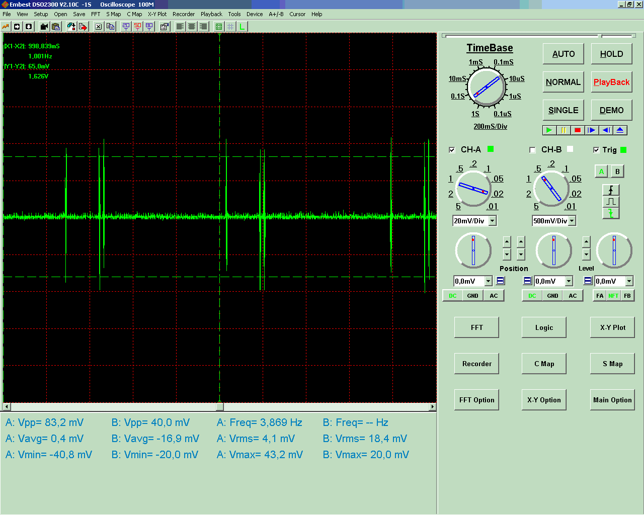

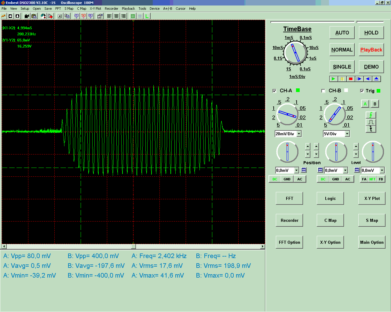

Hello, it is me again.
I perform the first test with an old electromagnet and record the following :
see attachement base time = 200 ms
and attachement base time = 1 ms
