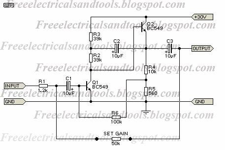

okok... thks guys... i found a low noise pre amp in google.. is this useful??
The transistor preamp is low noise and pretty good quality but it has a low input impedance. What are you amplifying?

Hi audioguru , i am amplifying a audio signal with 200mVp-p at 1kHz .. it will be used as a music wave and be amplify using a audio amp TDA7052.
i will like to have a choice of voice(filter the audio signal with a band pass filter), music ( non-filtered signal) or mute mode. This will be done using a transistor switching circuit which will receive a 2 bit signal that is stimulated by SPDT switches. The power supply will be 5V.

At that level, you don't need a very low noise op amp like you do for a microphone or phone pre amp. You could just use any decent op amp with adequate slew rate like an LF-356 or TL-084 or many others.
What is the preamp for?
The TDA7052 has a gain of 60 to 80. Then its output with a 200mV input will try to be 16V RMS which is 45.2v p-p. Its max supply voltage is only 18V and it is spec'd with a 6V supply.
the preamp is to stablize the input... but gathering all the info here.. i can conclude that my signal is rather big enough.. so an op amp will already stabillize the signal right?? how about the transistor as a switch part?? can anyone teach me?? thanks..=)
the preamp is to stablize the input... but gathering all the info here.. i can conclude that my signal is rather big enough.. so an op amp will already stabilize the signal right??
We don't know what you mean when you say "stabilize the output". Your 200mV signal is big enough to feed directly into a TDA7052A power amplifier.
What will the switch do? If you want to mute the audio then use the DC volume control function built into the TDA7052A amplifier. It mutes with an attenuation of 80dB.
