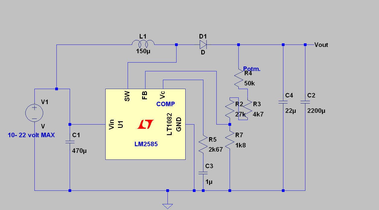

Help would be appreciated with this circuit... I need to be able to current limit the output in a very simple way so that it fulfills these criteria:
- only a few components used
- current limiting need not be very precise (+/- 50 mA),
- it is a solution that has a very low power consumption
- the short-term output voltage remains stable (+/- 15 mV, long term variations of +/- 50 mV acceptable) at an output current of max. 1.5 A.
Please also note that I do not use the LT1082 device but instead the LM2585. Its datasheet can be found here: **broken link removed**
For this reason the Vc pin is called Comp on the LM2585 IC. Other pins are identical as far as I can see.
In practice I have also made it into an adjustable boost converter meaning that the output voltage can be adjusted from ~23 volts to 63 volts DC with a 50k potmeter. It should still be possible to adjust the voltage when the current limiting is in place.
Suggestions are appreciated.
Greetings,
Jesper

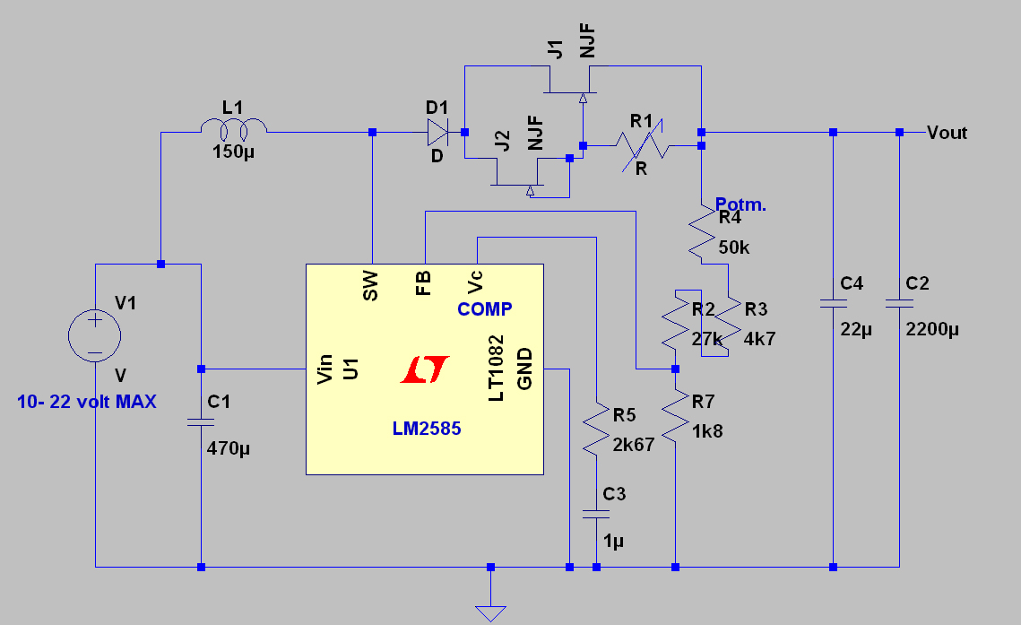

Hi Grossel,
- thank you for replying and suggesting solutions. I would be interested in seeing how the circuit in the above quote is designed in practice - I am not sure I understand where the pnp should be placed or connected .... ?
And then I've also considered it further myself and have come up with the solution shown in the attachment.
My idea is that J2 is a constant current generator which in combination with the variable resistor R1 sets a ~constant voltage between gate & source of J1, Vgs. This eventually causes J1 to conduct a current proportional to Vgs when switching voltage is above output voltage (+ probably a couple of volts).
By placing the circuit here, the LM2585's voltage regulation is still in place and by keeping the diode I hope to share a bit of the reverse voltage (I'm not sure this is the correct term) between the diode and the mainly J1. That is, if the output is e.g. 60 volts, and input 20 volts, there will be a reverse (DC) voltage of e.g. 40 volts that should be sustained by the diode and mainly J1 in series.
The hopefully only drawback is that it will sacrifice some of the circuit's efficiency ....
Any of you knows if this may work?
Thanks for considering,
Jesper

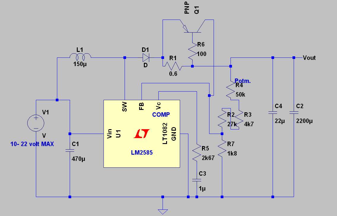

Thanks MrAl, I appreciate your suggestion ;)
I have drawn it up in the schematic - as I read it should be (?) - and have attached it to this post. Can I ask you to just check that wiring etc. is correct?
Also, I have looked in the LM2585 datasheet to see what the reference voltage on the feedback pin is, and it is 1.25 volts. So, since the current limiting need not be too precise I hope this will work ....
Thanks again to both of you - indeed a help with forums and people like you :)
Jesper
Hi again,
That drawing is almost correct, the only thing that needs to be changed is the output caps need to be connected right to the diode D1 cathode. The way it is connected now it may limit peak current to the capacitor, which isnt really the output current.
Remember to test it too.
Thanks MrAl - I'll change the circuitry accordingly. And will test it :)
Greetings Jesper
Hi - just to say that I've tried it out now and it works fine :) Thanks for your assistance & the best for your Christmas & New Year.
Jesper
