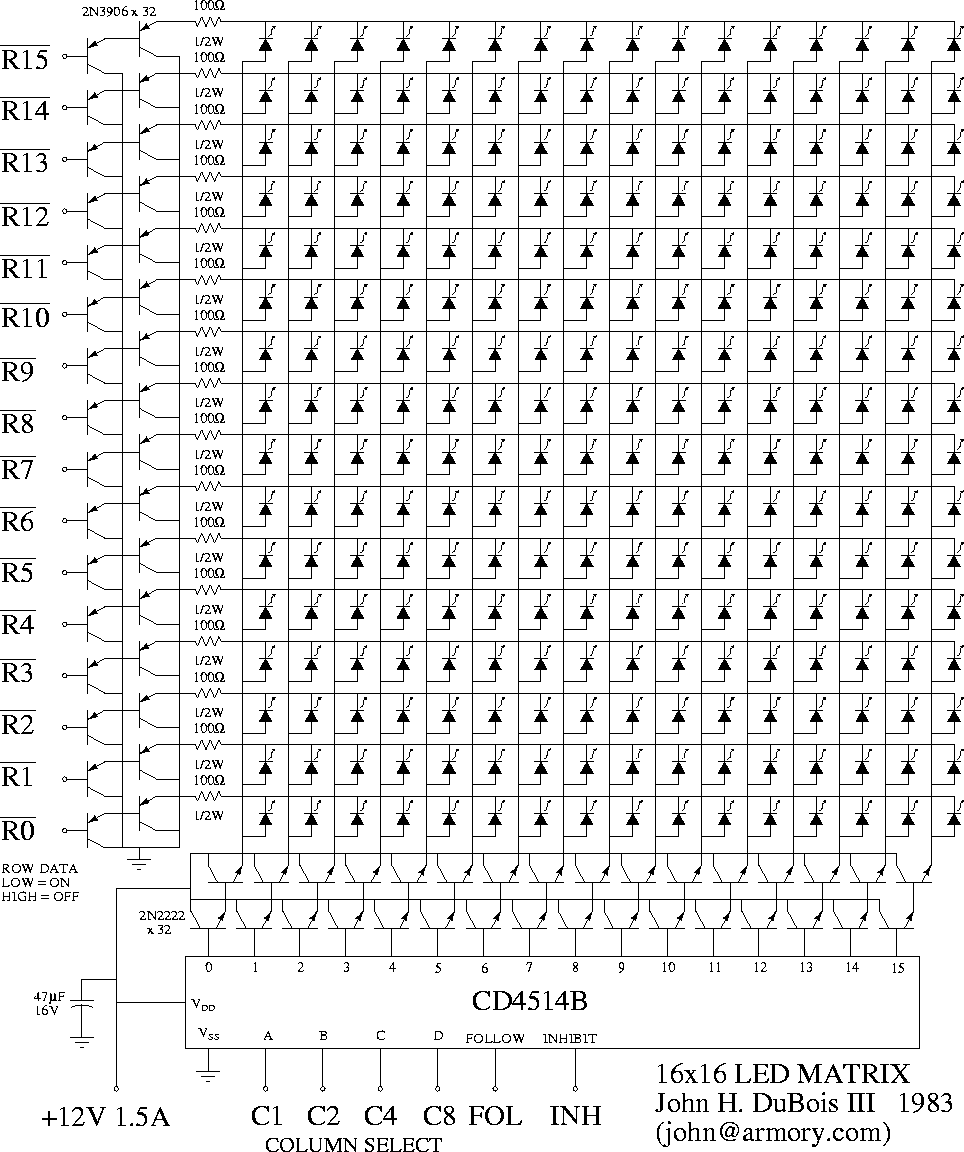

No, this is the schematics of a 16x16 led. You may try to build it. You must use some transitors like this. Because, if you connect them directly, you cannot control all the matrix

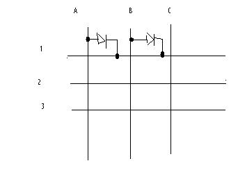

If I connect the led like this picture matrix.jpg, and I want to set A1 off, so A: LOW and 1 LOW or A: HIGH, 1:HIGH
Then, if A: HIGH, I cannot set A2 LOW
if 1: LOW, I cannot set B1 HIGH
So, try it with the first picture.
