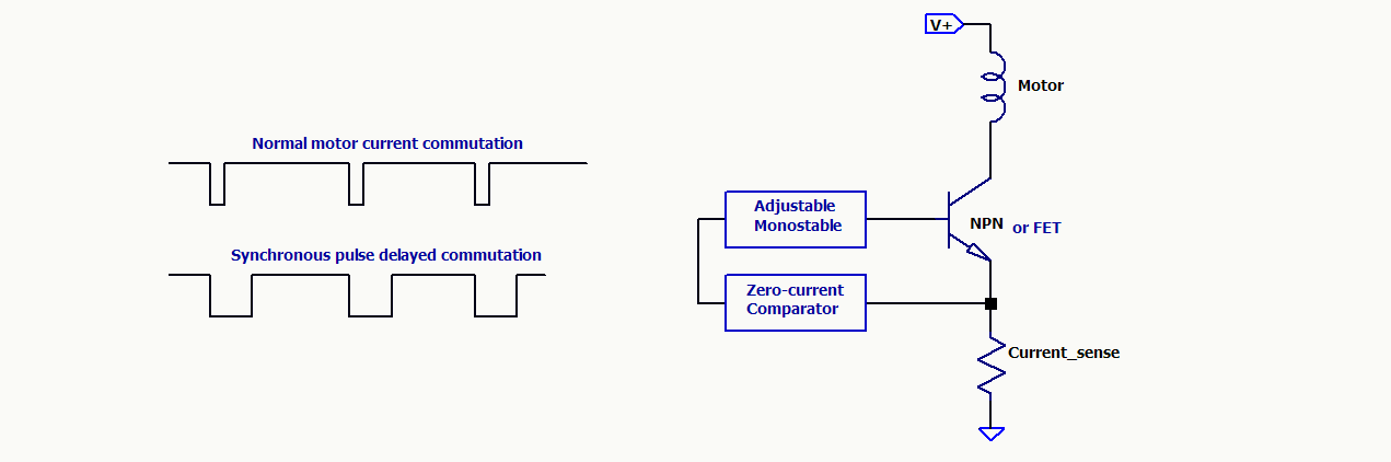

I did something like this some years ago when designing a speed control for a 2-wire BLDC motor (computer fan) which had internal commutation electronics of unknown flavour and no external access. I used a low-side-switching power transistor with a series current-sense resistor. Each time the sensed motor drive current dropped to zero during commutation I triggered a monostable and kept the transistor switched off for the duration of the monostable period. Simple. Varying the monostable period gave very smooth speed control down to almost zero rpm. This method avoids conflict between internal and external switching.

Hi alec_t
Would you mind showing if not a schematic, a simplified sketch?
Gracias.
Can't find my original schematic, but here's the general idea, Agustin :
The arrangement effectively stretches the normal brief current interruptions as the windings are commutated. As the transistor is turned off when there is already ~zero current through it, there is no significant BEMF generated so no interference with the internal switching in the motor.
Gracias Alec
Clever, on account you do not interfere with the current commutation but take advantage of it. Nice!
