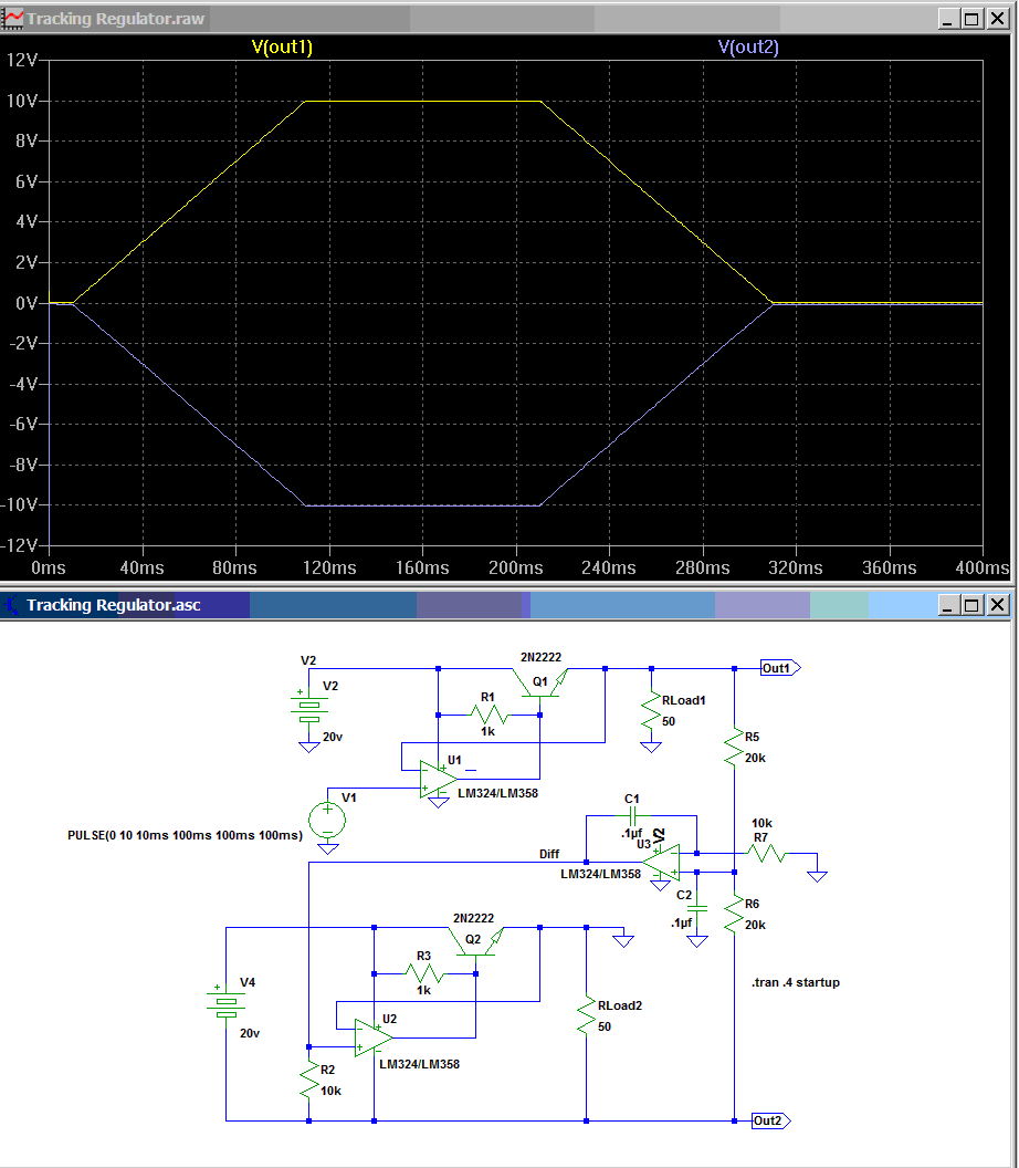

Below is the LTspice sim of my take on a circuit to do the tracking between the two regulators.
My regulators are a simplification of your basic design for simulation purposes.
After some virtual experimenting I found that the tracking could be done with one op amp connected as a non-inverting summing integrator (U3) without the need for an isolator.
The integrator solved an oscillation problem I encountered, and has the advantage of zero steady-state error.
V1 simulates the reference voltage adjustment for the positive voltage.
As you can see the negative output tracks the positive output as it ramps from 0V to 10V.
As an aside note, I have concerns about the stability of your basic voltage regulator. Transistors Q2 and Q4 in your circuit add a lot of open-loop gain which likely will cause oscillations when the loop is closed.
One option is to use Darlingtons for Q1 and Q2 in my circuit to get more output current without affecting the loop gain and stability.

Yes, after some further simulation I did find an oscillation in the minus output.
Placing a 1kΩ resistor in series with U3's output seemed to solve that.
Increasing the values of R7 to 20kΩ and R5 and R6 to 40kΩ also helps the stability.
And if you still have a problem, you can also increase the value of C1 and C2.

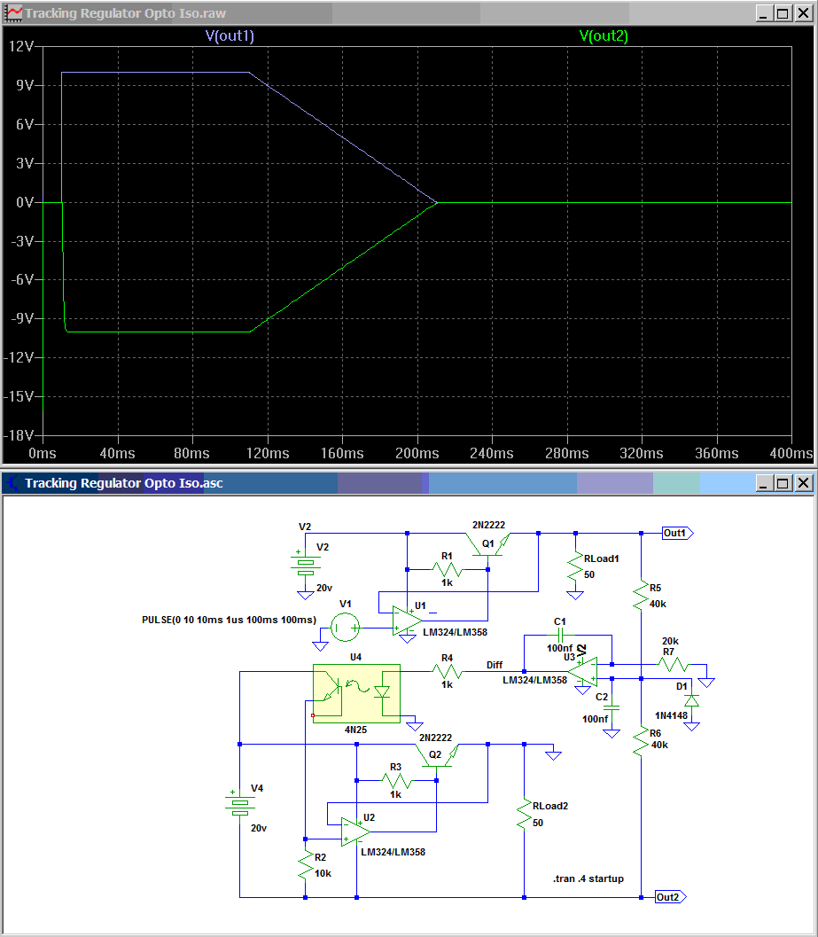

I modified your sim so that the amp drives the led of an opto-coupler as per your article, then its transistor can control the voltage on the slave. It either tracks ok but with oscillation, or it goes to max and stays there if I put in caps to stop the oscillation. Can't work out why.
Here's the LTspice sim of my circuit with a standard opto isolator.
I did notice a negative latchup under certain conditions which appeared to be from the op amp input going too negative under transient conditions.
Diode D1 seems to prevent that. A Schottky for that diode might be even better.
  • Tracking Regulator Opto Iso.asc
