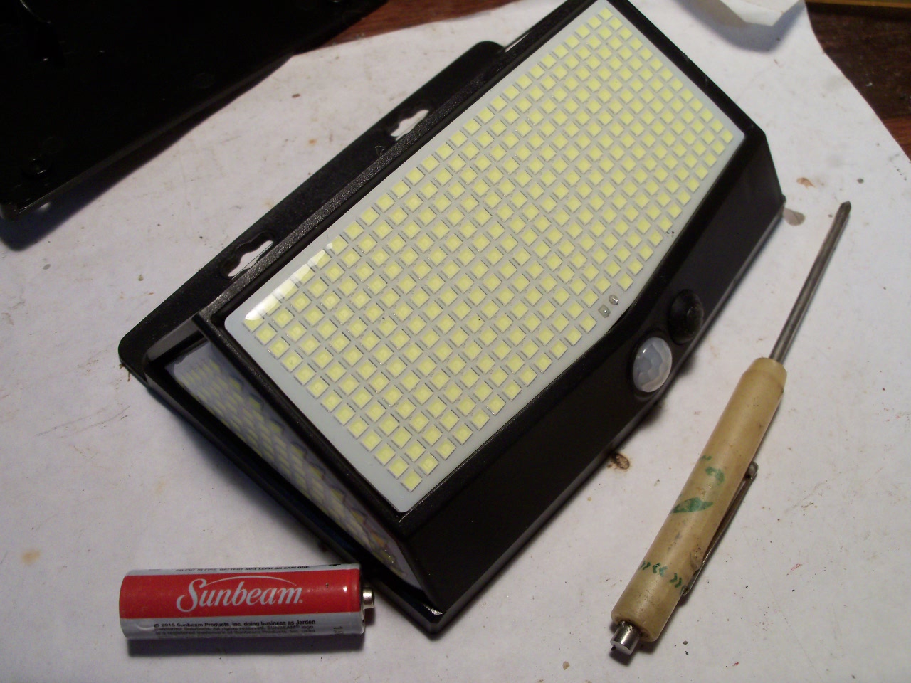

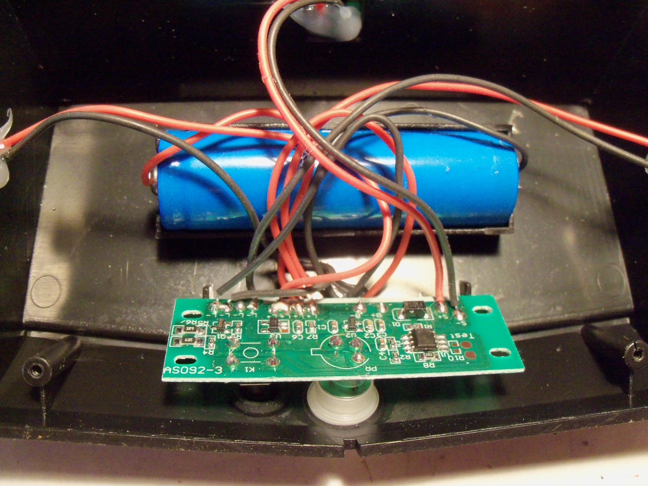

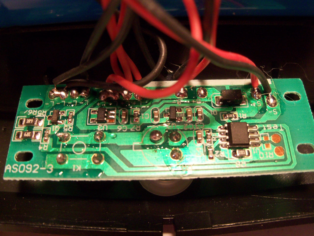

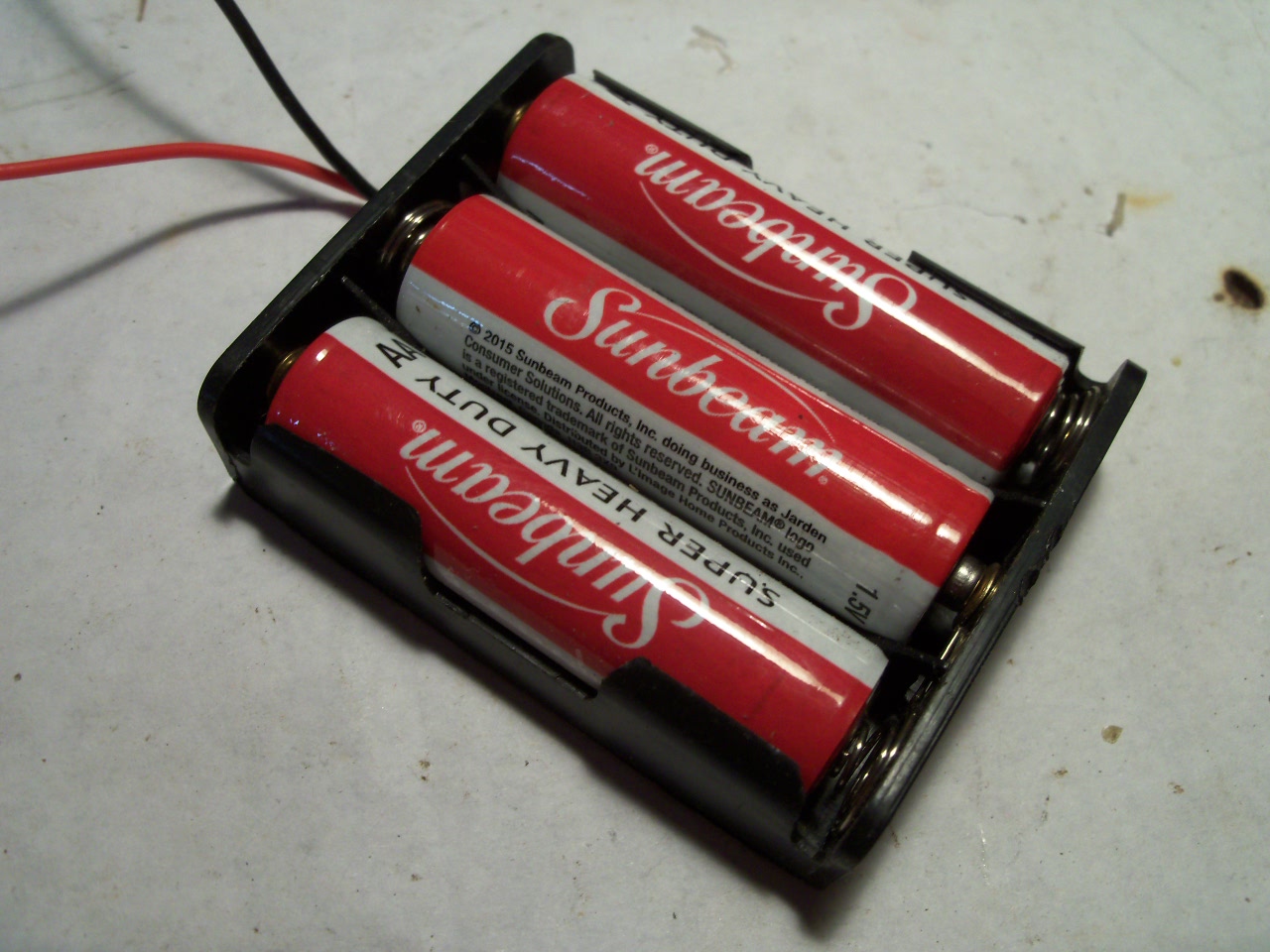

I finally found time to take this solar LED light apart. I tested the light in a closed dark good it make less light that some flashlights. It won't light up the bathroom enough to take a shower. Won't light up a bedroom closet very much either. This Dollar Store LED light bulb has about 15 LEDs it makes 40 times more light than this 208 LED solar light. I took the unit apart it appears solar is charging a capacitor meter reads 3.96 volts across the BLUE color thing. Is it a capacitor or battery, I short circuited the capacitor it made several spark over and over for several seconds it would not discharge so it must be a battery. Now battery voltage dropped to 3.8 volts after being discharged. I have 3AA eneloop battery pack = 4.2 vdc. I have 3AA everyready battery pack = 4.8 vdc. I wonder if it is save to replace BLUE color battery with 4,2 vdc eneloop battery back to see what happens? I think I should stay below 5 volts DC. I might be safe to use the 4.8v batteries.

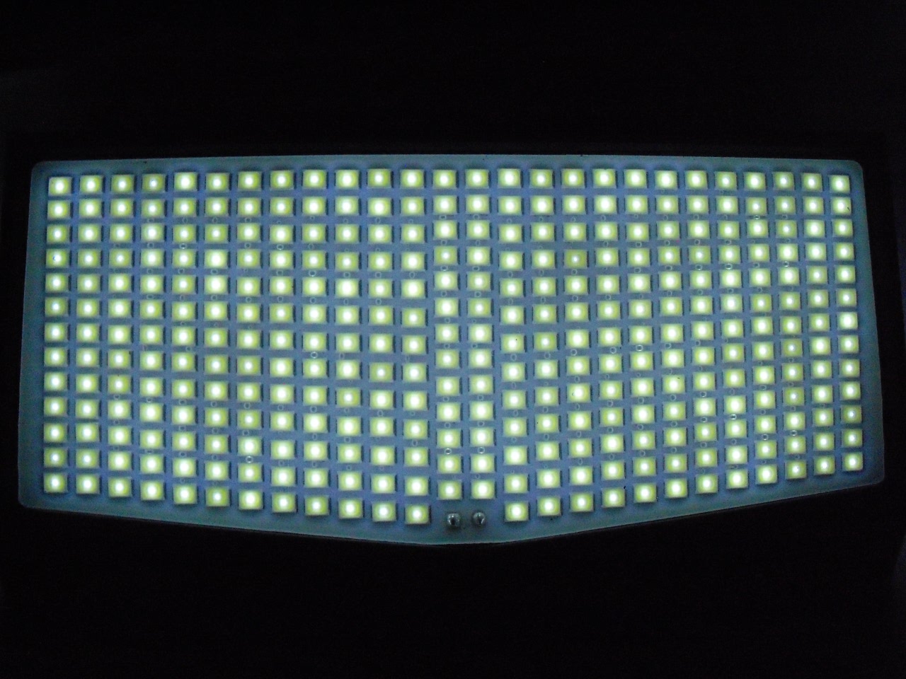

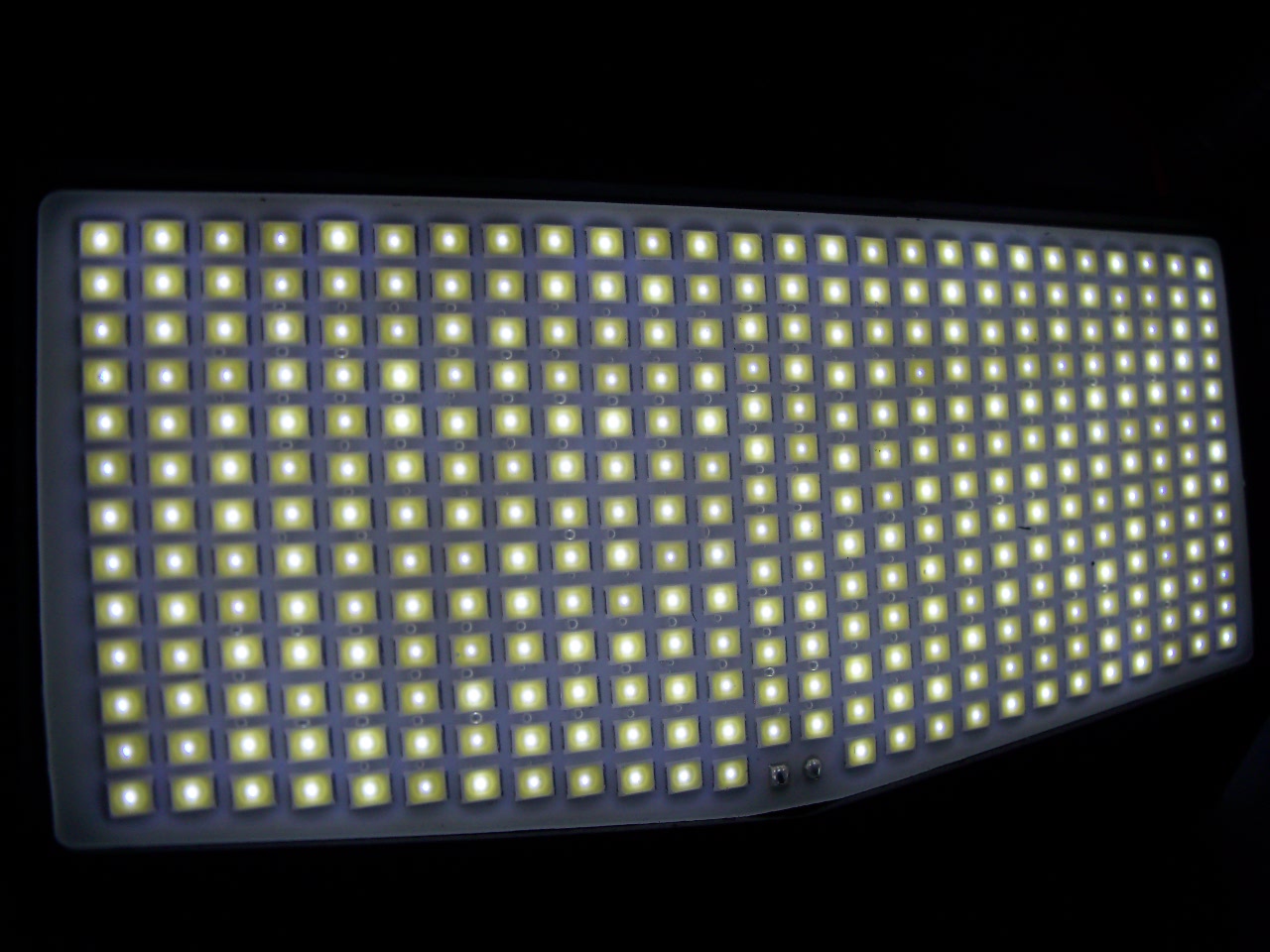

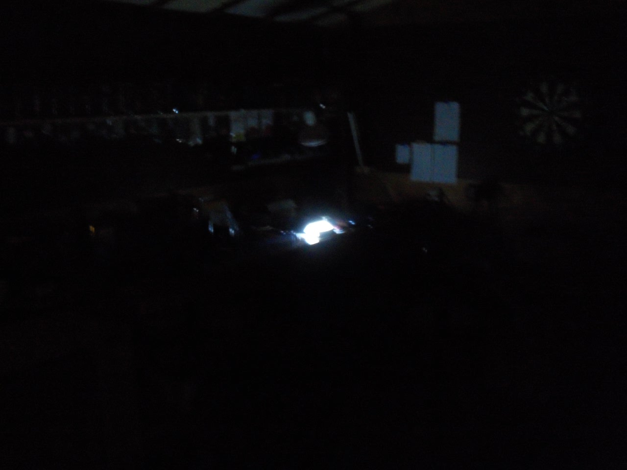

I tried both 4.2v and 4.9v the light is not much brighter. Close investigation what looks like yellow square LEDs are rally yellow plastic squares with a very tiny white LED behind each yellow square. This light is a SCAM all it does is make enough light so the light can be seen but no light is produces to light up anything. Look at the 3 pictures. Light hardly makes any light in this mall 7ft x 10ft room. You can see a tiny white spot center of each yellow square that is the very tiny LED on the back side of each yellow square. Beware of deceptive advertising that does not tell you Lumens and sellers that will not answer questions. This product was made to sell, it was not intended to work as a security light.
The single blue battery might be Ni-MH at 1.4V and the electronic circuit steps up the voltage. But since the solar panel looks like it makes 5V then the blue battery is probably a Li-Ion cell that is fully charged at 4.2V and the electronic circuit is its charger.

I unsoldered the blue battery when I tested it meter says 3.96 VDC. Seller was from San Jose CA.
I made a mistake this light has 468 LEDs. My Batteries are 4.98 VDC 2 amps. I can try different batteries 5 VDC 8 amps.

The lie 3.96V battery cell is an 18650 sized Lithium-Ion that is fully charged at 4.2V.
Which battery you have produces 4.98V at 2A? The cheap AA Sunbeam cells are old fashioned carbon zinc that drops its voltage with a load more than 100mA (0.1A).

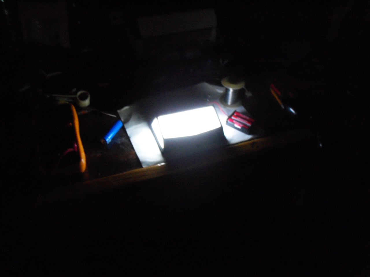

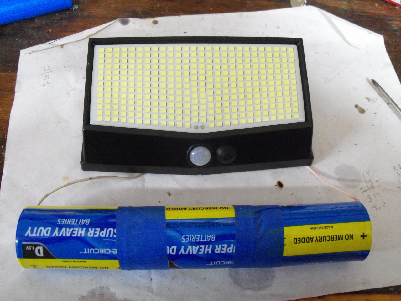

3 new D batteries soldered in series = 4.95 VDC 4.8 amps. D batteries 30 years ago were always 8 amps but not anymore. I soldered the 3 D batteries in place of the BLUE battery the 468 LED lights are not any brighter. This in not even 1 Lumen. Probably not 1/4 Lumen. It is easy to see in the dark but it makes no light. The camera sees better than me, the 2 photos taken in the dark shows it is slightly brighter than before but
Super Heavy Duty batteries (carbon zinc) were made 65 years ago. A Chinese D cell one has trouble producing 100mA (0.1A). Its power drops when stored for 1 year (on the boat then in the store). They do not show a "best before" date.
A modern Energizer Alkaline D cell can produce 8A for a while. They are guaranteed to work after 10 years of storage. They show a "best before" date of 2030 or 2031 today.
Did you measure the voltage of your batteries while they powered the LEDs? Then only 3V or less?

Volts drops to 4.85v with LED light on.
You showed a 3.96V blue battery that the solar light came with that is 4.2V when fully charged. Now you are feeding an over-voltage that might destroy the light. It is designed to be dim.
All this worthless light does is become visible when it comes ON so it can be seen, but it makes NO light to see other things.

A lithium battery is extremely dangerous (explosion and fire) if over-charged but the very cheeep light might not use a proper lithium charger IC, maybe it simply does not charge to 4.2V, maybe only to 4.0V. The solar panel and battery cell are probably low quality then they cannot produce much power.
