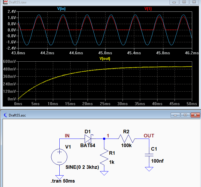

I want to hear what the filter is doing. I can put sound through the filter then dial the frequency up & down I should be able to hear sound at 3KHz then sound will be less above and below that. If I built a 2 stage filter then 3 stage filter I should hear the difference. I have no scope to look at filtered sound to put in 2KHz or 4Khz to see how well it works. HOW would you do it if you had no scope?
R
I would rectify the voltage with a diode, resistor and capacitor, and measure the average value with a multimeter on its DC range (Edit: See below).
(Most multimeters likely will not work well to measure 3kHz on their AC range).
