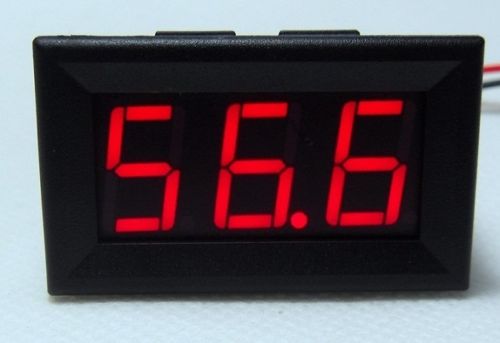

The ones I have say they will take 99.9A but by no means are they heavy duty. There just a .56" digital meter. Here it is so you can see for your self. I didnt realize they were so cheep made but for less than 5 bucks I thought Hell yeah when I seen them. **broken link removed**
The ones I have say they will take 99.9A but by no means are they heavy duty. There just a .56" digital meter. Here it is so you can see for your self. I didnt realize they were so cheep made but for less than 5 bucks I thought Hell yeah when I seen them. **broken link removed**View attachment 86919

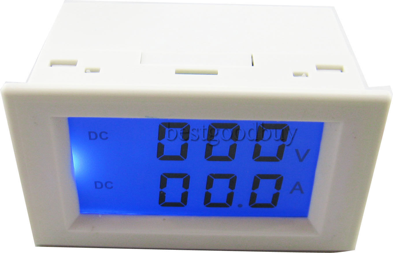

I like this one **broken link removed** but there are many to choose from. Like to find a place that sold ones for AC and DC that matched tho. Ill do some searching I guess.
