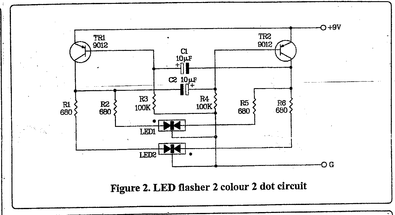

hi, this is a circuit that changes the color of the LED.First, LED1 is red and LED2 is green, then LED1 is green and LED2, and this process continues. Can someone explaine to me how it works? thks.

Bro fugrammer i saw ur cct.it just a astable multivibrator.only change it uses two pnp transistors.
according to my specifications it changes the colours from first (led1 red, led2 red) secondly (led1 green,led2 green).not like u describe (led1 red,led 2 green) secondly (led2 green & led1 )

This certainly is an Astable Miltivibrator. (Aka free-running multivibrator) because it cannot rest in one state, it constantly alters. As the capacitors charge and dis-charge, they alter the state of the transistors (ie. switch them on and off) which controls which of the led's is lit. It's basically a flip flop that triggers itself constantly.
hope this explains how it works.
The beta of those transistors would need to be well over 200 if you want the period of oscillation to be predictable and stable. Also, base-emitter breakdown will make the period unpredictable, and can cause beta degradation.
I would add a general-purpose diode between +9V and the junction of the two emitters (anode to +9V), lower the values of R3 and R4 to 10k each, and change C1 and C2 to 100uF each.

Your specifications are ignoring the polarity dots on the bicolor LEDs.
