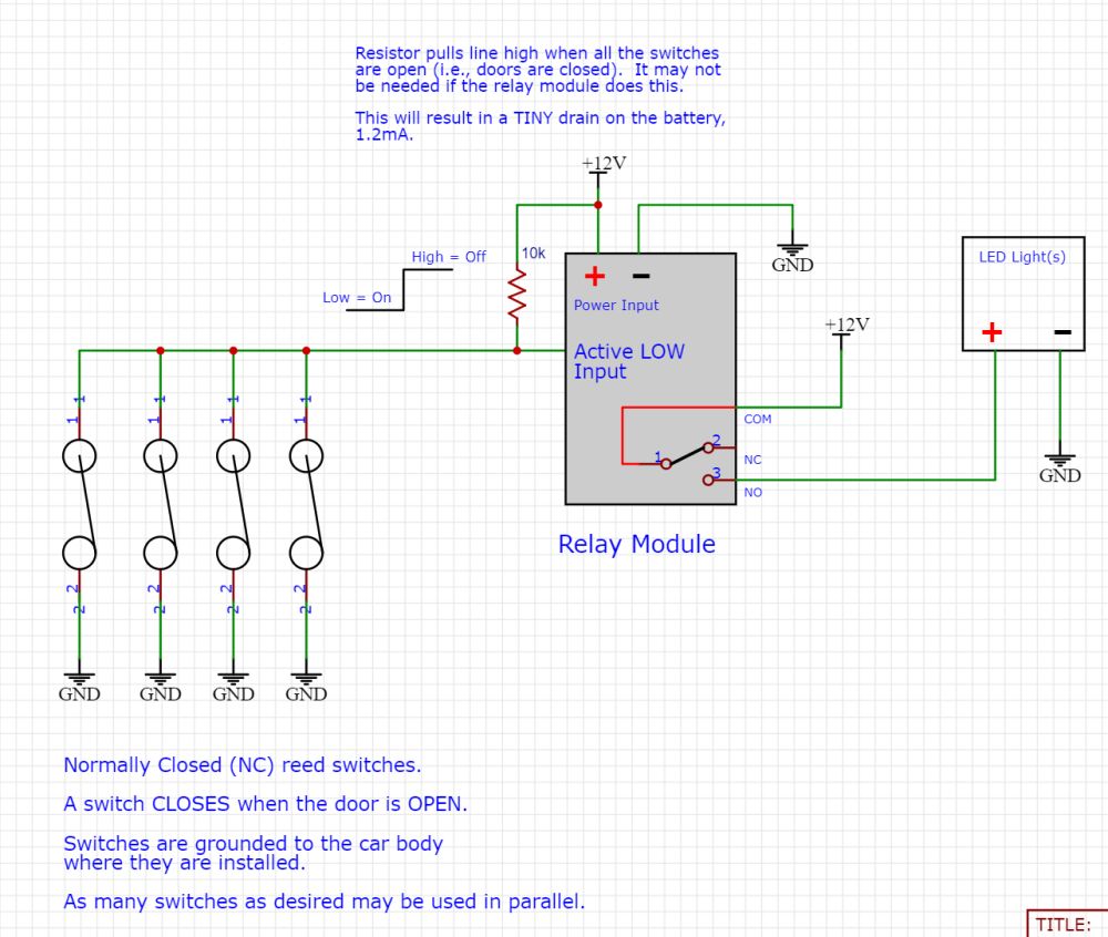

Im not all that great with drawings. It is basically a set of storage drawers in the back of a vehicle. When opening these drawers I would like to turn an LED (located inside the drawer). Similar to how some display cabinets have the "light on open" option. I have seen this done with magnetic switches and also push style switches, I wanted to go down the magnetic switch route.

What I had come up with so far was a NO magnetic reed switch on the inside of a drawer that when the magnet would separate then the LED would come on like an automatic switch. Now when I tried this the LED barely lit up, it was very dim compared to lighting it directly from a power supply or through a simple switch (like a carling switch). With this I then presumed that I needed a relay, something that takes a very small current to switch that would allow "full power" to the LED's. I.E use the reed switch to send current to the relay and the relay powers the LED's.
My mistake was that I believe the relay I bought seems to want more power to "switch it on". My original question I suppose was how much power do I need to turn my relay on, how would I find out how much mine needs so I could find a magnetic reed switch that would provide this power. Now it seems there are better options (better relays) to allow me to do what I originally intended. So now my question has turned to "how do I wire up the new relay that I found?".

But for the moment, let's assume you can find a suitable NC (Normally Closed) switch, which means the switch is open when the magnet is near (meaning the door is closed).
